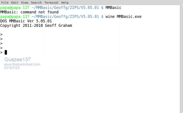

Has any one got DOS MMBasic to run under linux?

Havent been able to run under linux. Dosbox does indicate it needs Windows. Wine doesn t like it either. I would have spend more time on it if the dos version had some elementary form of graphix.

Volhout Thanks for trying too. I tried a few ways still no luck.
Funny thing I created a folder and put MMBasic.exe in it.
then opened folder in a terminal
then type wine MMBasic.exe
I get this
I can ^C and it responds moving the > down a line. But no other keys work.
So near but so far away. Other ways to do the program but this just

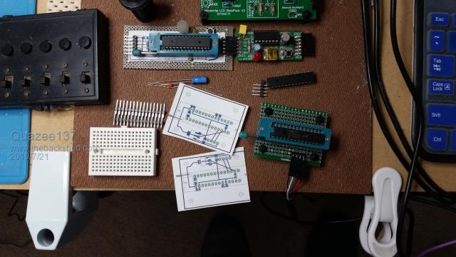

It's also the way I put MMBasic on the 60 chips. Then used the zif one I
posted to upload the basic program.
It was when I made the usb to zif that got me thinking of using Pic32Prog
to read the preset up chip and do MMBasic + program + options for the rest.
