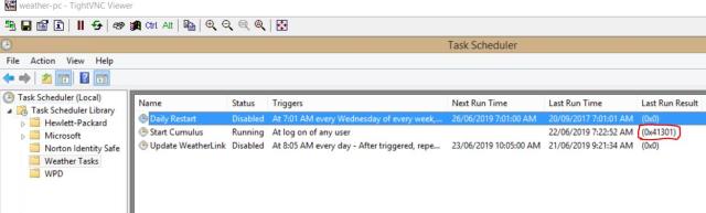

Would like to automate it so it happens at least every day, but always seem to get in a know athe the launch task is constantly sitting in the running state, (0x41301) untile Cumulus is terminated.

That's where I reckon it's somehow related to the (0x41301) status that the Scheduled tasks sit in.
That's the "Still Running" state.
I reckon I need to have it get to the (0x0) state, completed, before doing other stuff.

This.....
The task still running....
I think I need it to reach the "Completed" state once CumulusMX.exe is launched & running.
