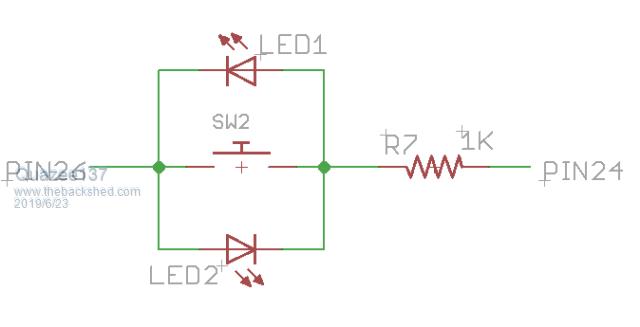

Was trying to get a bit more from the 28 pinner.
I needed a bipolar led an a button.
So took the led and added the button.
and to test the idea.

nice on how far and easy MMBasic lets us push this little one.
