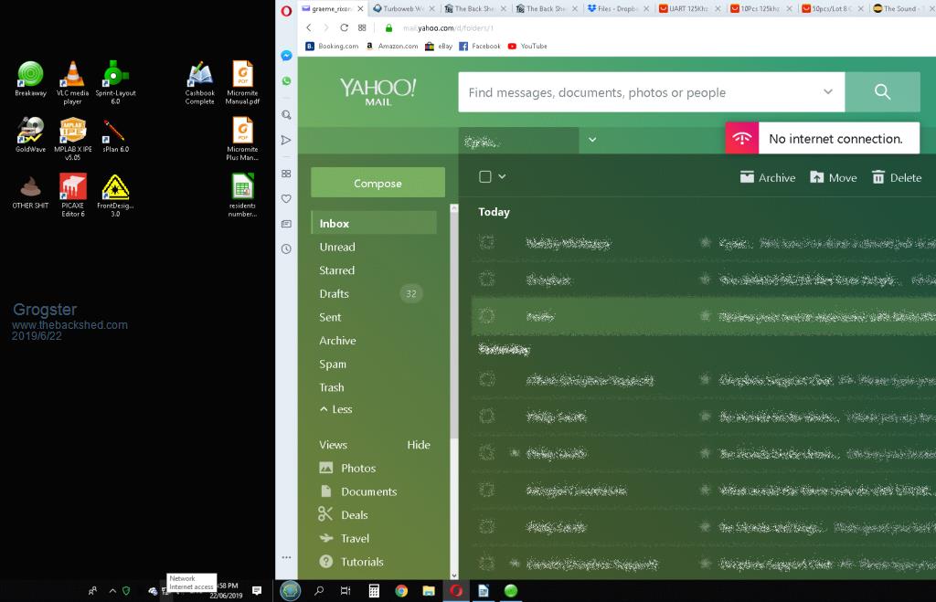

Just happened again now. Mother ....
Ping command says it cannot find the host. I just tried to ping yahoo dot com.
An image of the problem I am seeing:
I have censored all the email messages for privacy, but you can see the "No internet connection" message in the web browser, and the "Internet access" message on the network taskbar icon.
One directly contradicts the other, and I am left scratching my head.
