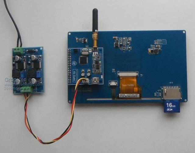

3v3 and 5v connected to 7" panel, via two external buck-converter modules. I will upload some photos shortly, of how I have everything connected.
EDIT: Here is the photo of my arrangement:
The MM+ board talks to the 7" LCD, and the PSU on the left of the image takes a 12v input and provides a 3v3 and 5v supply to the MM+ board.Edited by Grogster 2019-06-21

Definitely not the USB, as that is not connected when I cycle the power when I have this problem, so it SHOULD just restart. IE: Can't be parasitic power, and the MPD board does not route the UBB 5v line past the USB socket.
It's really odd. This is not my first LCD either....
No error messages when I type something like GUI TEST LCDPANEL, but you just get nothing on the screen at all. DISABLE and OPTION LCDPANEL and you are away again.

@ Geoff - Yeah, I would have thought so too, but both the LCD and the MM+ are being fed from the same 3v3 supply. The 5v supply, is only there for the HC12 and the 7" LCD backlight - the "5v" pin. For whatever reason, the manual reset totally fixes the problem, so I am a happy chappy.
