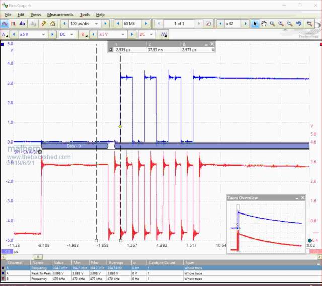

Posted: 07:15am 21 Jun 2019
The code posted above definitely works but there is a "funny" with the STM implementation which may be affecting you.
Both the data and clock lines seem to go tri-state off when not in use and the clock voltage will drift down towards 0. If you are using mode 2 or mode 3 then it may be worth trying a 10K pullup on the clock line
The attached version sets a pullup internally when mode 2 or 3 is selected
2019-06-22_193408_Armmite1.3bin.zip
2019-06-22_193425_Armmite1.3hex.zip Edited by matherp 2019-06-23

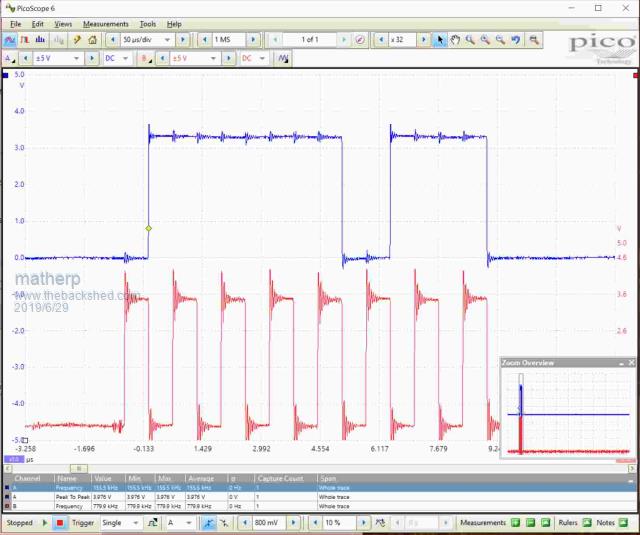

MOSI on SPI3 definitely works properly on pin 48 in 5.05.07. You must have a dead pin/or connection. The backpack PCB is wired for pin 48 so I don't want to change that. It was a temporary error when it was set to pin 135.
The trace below is from my development Nucleo and backpack with the binary above and MOSI tied to MISO
SPI3 OPEN 1000000,0,8
? SPI3(123)

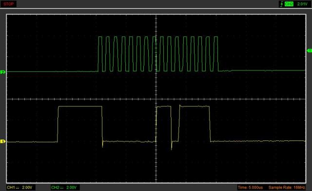

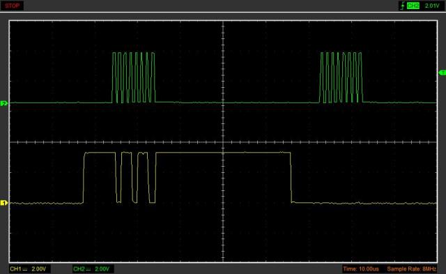

I think I have worked out what is wrong with your 5.0507 firmware for SPI3.
It only clocks 8 bits when a 16 bit write is requested.
Here is the SCK(green) and PIN48 MOSI(yellow) for a 16 bit write ver 5.0507
Here is the SCK(green) and PIN135 MOSI(yellow) for a 16 bit write ver 5.0506
Your SPI3 firmware for 5.0507 has a problem with accepting a 16 bit write.
thanks John
Just know enough to get me in trouble, but not quite enough to get me out.
