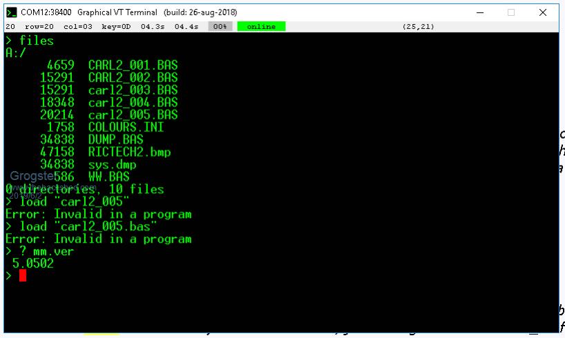

Latest beta will not let me load any program from the SD card:
Note that I am not in a program, I am at the command line....

  Grogster said   Howdy.
on my mm+ version 5.041, all is ok
test font is also ok
I think you have an pb with your 5.5.01/02 versionEdited by goc30 2019-06-03

Yes, but you are using a different version.
Try flashing the latest beta into your one, and let us know if you get the same error.

Hi grog
with new version (5.05.02), command "load testgrf.bas" don't work like your version
filename with 7char or more is same
but test font is okEdited by goc30 2019-06-03
