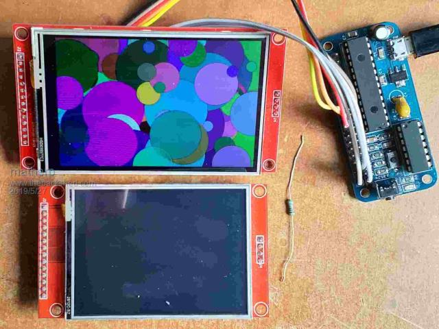

The 3.5" ILI9488 display is 480x320 pixels and RGB666 and is shown against the 2.8" ILI9341 display for comparison. Drivers are attached for the MM2 and MM+. The pinout on the display is identical to the ILI9341 and it is available from here
The MM2 driver supports all the normal drawing commands. In addition the MM+ driver supports transparent text, image load and blit.

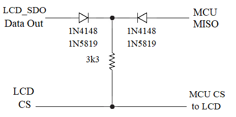

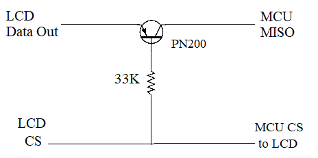

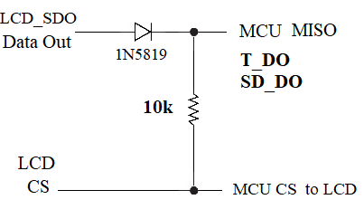

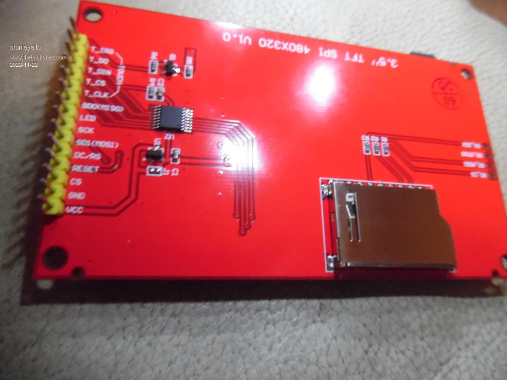

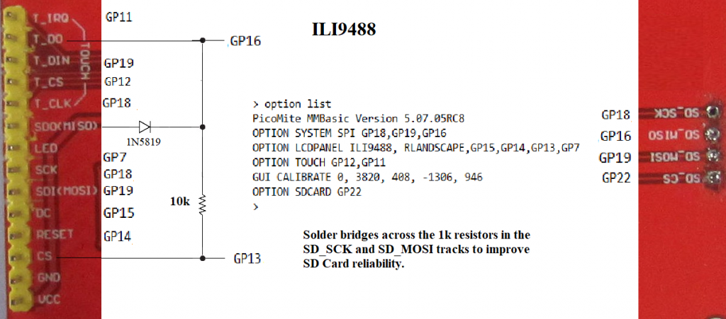

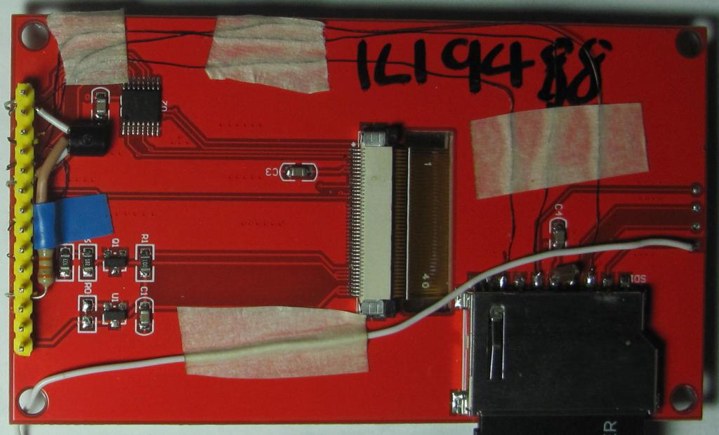

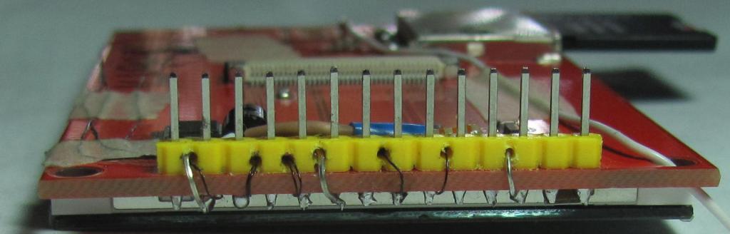

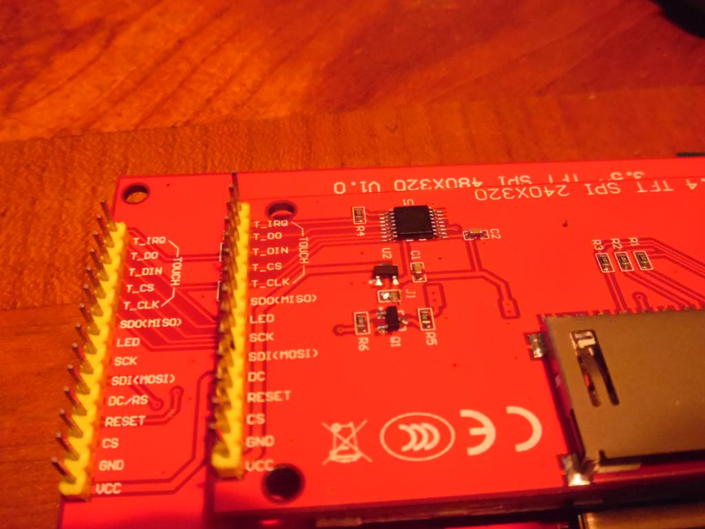

There is one very strange thing I found on my version of the display: Touch and the SDcard share the SPI port with the display. I found that the SDO(MISO) pin on the display (SPI input from the display to the Micromite) interfered with the SD_MISO and T_DO pins even though the display wasn't selected (CS high). This could be fixed by connecting SDO(MISO) to the Micromite through a 680ohm resistor - very strange.
SDO(MISO) should not be connected for the MM2 and is only needed for the MM+ if blit or transparent text are needed. Otherwise leave it disconnected.
The display isn't very fast as there is a lot of data to move over the SPI bus (480 * 320 * 3 = 460,800 bytes) for a full screen refresh but if you need a higher resolution display on the MM2 it works nicely.

Posted: 11:00pm 19 Mar 2021
I recently renewed my SC subscription and thought I would also get some Micromite backpack v3 PCBs and a 3.5" LCD panel.
I assembled everything and the console worked perfectly, but when I plugged in the panel, the backlight came on but the console was frozen. When I removed the panel the console worked and said the driver was loaded.
Given Peter's comments I checked the PCB wiring and noticed that pin 9 on the LCD panel isn't even connected. I tried a 2.8" panel and it worked perfectly.
So I used extenders to connect just pins 1-8. The LCD worked perfectly. I then added extenders one by one expecting it to eventually no longer start. Eventually I had all the wires connected and the LCD and touch both worked perfectly. I removed the extenders and plugged the panel straight into the backpack. It is clear the the backlight is working as the panel is initializing when the screen clears, but the console doesn't work.
It is pretty weird, as it almost as if the extra resistance of the extenders is allowing it to work. I put it away as I am happy to use it with extenders if required, but I will appreciate it if anyone has any ideas.

I probably can't help but more information would be helpful.
Which driver are you using? Peter's or SC's? Did you follow the setup procedure from the article and set the screen parameters to suit the board as per the article?
SC does mention the problem with the MISO pin.

  Quote  TFT SDO does NOT tristate when CS is high
Yes, this is more or less what SC said in their May article when they were first testing the display and also why Peter's 680 ohm resistor is a solution. SC just left it disconnected on the V3 backpack board.

  damos said  It is just weird that it works through the extension cable, but not when plugged in directly.
The extension cable might be adding enough capacitance to make the difference.
I would consider capacitance over resistance in this instance.
Which pins want the extra capacitance might be difficult to determine.

You could connect a 10k resistor from pin 5 on the 1455 to +5v. That has known to be a problem. Maybe the proximity of the display when plugged in is affecting Rx to the micromite by injecting noise while the signal is initially open circuit. Jim's capacitance suggestion just woke up one of my brain cells.

I'm trying to run Peter's driver on an ILI9488 display plugged into an MM+ 64-pin backpack board.
SC's programs run OK; I've removed the MOSI pin... But I can't get Peter's driver to work.
Can I expect Peter's driver to work on my set-up, please?
And if it does, can I expect the GUI graphic controls to work OK too?
Thank you.

Sorry, I can't help but assuming you are using the correct MM+ driver it should work and I would expect the GUI controls to work also. I hope someone can verify that for you.
Posted: 10:01am 05 Jan 2022
  Quote  I've removed the MOSI pin
I hope that is a typo. The MISO pin is the one to remove (Master in (the uP), Slave out)
