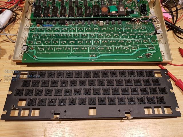

I removed the keyboard, tested and pulled most of the key switches apart, wiped the contacts and rubber contact with some rubbing alcohol. There is a documented mod to replace a 3.3k resistor array for the keyboard with a 33k, I discovered my resistor array were 4.7k, and the only replacement I had was a 10k, so fitted that.
Put it all back together and I still have a couple of keys that are not as responsive as they should be, so I might order in a 33k resistor array.

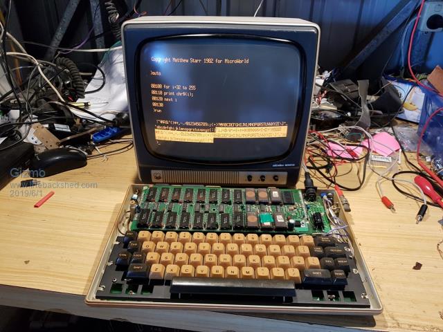

A couple of restarts later, the Bee beeped as usual, but no screen. It was dead again, but a different fault. The address and data lines seamed to have normal activity, but the keyboard and screen were totally off line, which points to the 6454 IC. Poking around with the cro and I could not see the 12MHz clock signal to the chip, tracked that back to a 74LS161 near the crystal oscillator. Replaced it with a 74161 from my parts drawer, and once again the Bee burst back into life.
Next I dug up a genuine Microbee amber monitor I picked up a couple of years ago ( Thanks Rod ). First thing was to take the back off and check for dry joints, etc. Resoldered a few, and noticed the mains transformer seamed to be awful big for a small monitor. I also noticed a 12v plug on the back of the monitor. Light bulb moment, this monitor is designed to power the Microbee.
All back together and running.

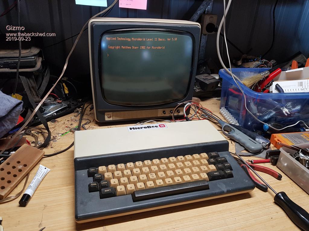

Well its finished.
I left the case in the sun for a few days, definite improvement in the yellowing. Also repaired a few key switches with conductive paint.
Feels like reuniting with a old friend.
