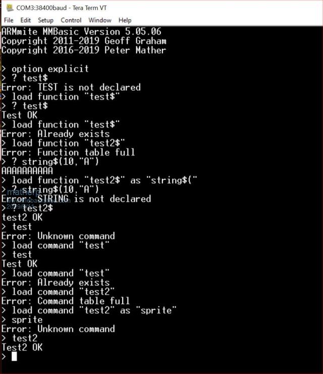

The ArmmiteH7 and the MMX have lots of flash memory available but are limited by the number of commands and functions supported by MMBasic (127 of each). Geoff has quite rightly pointed out that changing this is a big job and risks de-stabilising the code.
I've worked out a way of getting round the limitation by allowing the user to select the commands and functions they want available, where necessary substituting them for existing ones. The Armmite H7 currently has 126 commands and 126 functions pre-defined out of a maximimum of 127. The attached screenshot shows how I have engineered the code to allow extra and different functions and commands to be used.
The LOAD FUNCTION and LOAD COMMAND statements can be used either at the command line or in the MM.STARTUP subroutine. They cannot be used in a program as the RUN command tokenises the functions and commands so they must all be pre-establised. The function names to be replaced must include the "$" where appropriate and the opening bracket where it is shown in LIST FUNCTIONS. The command is insensitive to case and AUTORUN works as expected as long as command and function usage is defined in MM.STARTUP.
Print test$, test2$
Test
Test2
Pause 500
Sub mm.startup
Load function "test$"
Load function "test2$" As "string$("
Load command "test"
Load command "test2" As "sprite"
I think it is very unlikely that a user couldn't find unused commands or functions to replace in any specific program so I think this approach gets round the current limitation without compromising stability of the core MMBasic code.

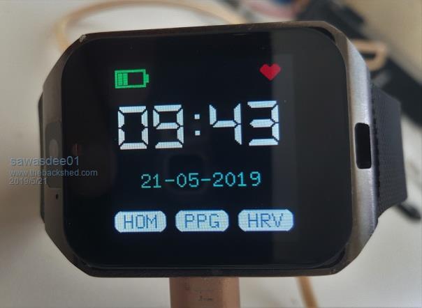

I would like to preface this post with the admission that I know nothing about the 'inner' memory model for MMX or the ST variant of Micromite - so, if there is some confusion about the role of Flash or Ram in this respect.... apologies.
I have had two instances where I had to take steps to reduce the memory footprint of the program that I was developing for the MMX+ and I think that I will shortly be encountering the same issue with my STM32L432 based smartwatch:-
In both previous and the now likely third instance, the GUI components take up a very considerable percentage of both the 'lines of code' aspect of memory and also the number of variables used. Additionally, I tend to use bitmap objects and various fonts to bring the end result into the realms of what is expected.
Despite using some tricks to limit memory size, such as chopping unwanted characters out of the fonts that I have created, it is not at all unusual for me to burn up 10k bytes + in fonts and bitmap images.
A quick look at the front screen of the watch and you will see; the Battery use bitmap (there are 5 battery images, one for each 20% of battery utilisation), the flashing heart bitmap, the super sized time font (numbers only) and the GUI buttons along the bottom. Yes, I could do some trickery to use just one Battery image and then dynamically draw inner battery gauge bar - but that would increase lines of code and possibly reduce inner loop state machine responsiveness.
Additionally, on the MM+, I tend to build the entire graphical environment when the application first starts and then just use the PAGE command to switch to the relevant screen, as required. My guess is that fewer graphical objects could be used if I destroyed and then re-built each screen, as necessary - but, once again, this would be at the cost of more lines of code and inner loop responsiveness.
I have never considered strings to be a problem whatsoever. I tend to use the LENGTH attribute quite a bit and I also keep most string variables as being LOCAL, where possible. I admit to being quite lazy with global string constants and tend to define them using something like DIM Fred$ = "Help!". I sometimes wonder whether a better approach might me to declare them as type CONST and then assign to a LOCAL string variable inside a subroutine (?). I would be interested to understand what works best for the memory model. My guess is that defining global string constants as type CONST is going to be much easier on RAM - but this assumes that FLASH CONST isn't dumped into RAM during startup.
Finally, on to the question at hand - what to do with the extra, unused flash. While it is way above my pay grade to suggest solutions - here are some poorly thought through wish list items:-
1. Some way of pushing all of those bitmaps, additional fonts (and maybe, even C functions) up into the 'outer space' on-board MCU flash - ie without using an external flash chip. There might even be a way of doing this without extending the MM command set - eg a pre-processor / MMEDIT / Utility sort of thing.
2. Easy one - a new chapter in the existing Micromite Manuals entitled 'How to save and manage Memory'. On first glance, this looks to be a small topic - but once past the simple stuff, like setting up MMEDIT correctly, so that it chops off comments, defining multiple variables on the same line, using the LENGTH keyword, etc - there is a mountain of stuff that is much more nuanced.
For instance, does DIM Fred% = 10 use less memory that DIM No_Of_Freds_Fingers% = 10? Additionally, do both of these variables execute at the same speed ?
3. I really like the LIBRARY command in Micromite Basic and I wonder whether it could be extended with something that looks a little bit like the FROZEN utility in micropython - so that the LIBRARY could be (optionally) sent up into the 'outer space' on-board MCU flash.
Interestingly, if combined with a command to disable LIBRARY LIST, this approach might go a long way towards providing the language extensibility mentioned by Peter - as it would allow new commands to be added to this 'invisible, out of core flash' area so that they behaved as though they were part of the normal MM Basic offering.
This approach might also be necessary to support future heavily integrated CPU + network products - eg Nordics Nrf52840 ARM Cpu with Bluetooth 5.0 BLE 1Mb Flash, 256k Ram. One could imagine a Nordic Softdevice (the core Bluetooth Stack and API) living up in this secured Flash area, along with a MMBASIC wrapper to make the Bluetooth API available to MMBasic programmers - how cool would that be?
