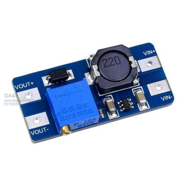

I have a need for some boost modules to activate some 12-50V DC pulse solenoids from a mite. I have chosen to use the MT-3608 pictured.
I have placed a 4700uF cap across the output to provide the current needed to latch the solenoid for a 150ms pulse from a relay. The problem is that the in-rush current to the cap is destroying the chip and letting the smoke out. I think that I need a resistor between the module and the cap. Can anyone give me an idea of the value needed that would limit the current to the cap and also provide a timely charge up time?

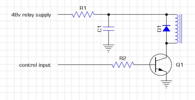

quite seperately, you'll then have a switching trasistor to turn on the solenoid itself:
in the above, pick C1 to provide enough 'oomph' to pull the solenoid in, R1 high enough to not exceed the peak current output from your boost converter yet low enough to not drop too many volts when Q1 is on, and make R2 around 680 ohms or so so that Q1 is fully saturated when activated.

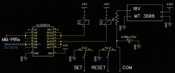

Here is a rough schematic of my cct.

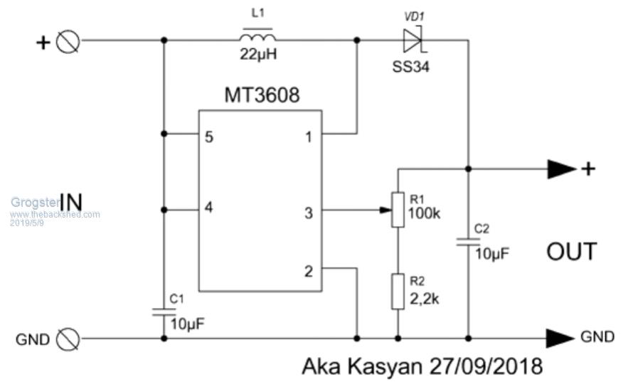

These modules do have a habit of burning out the chip if they are adjusted incorrectly. Page two of the PDF for this boost-converter chip, states that the voltage on the FB pin(3) is 6v absolute maximum. Many of the modules from eBay etc don't use the correct potential-divider arrangement, and if the multi-turn trimmer is set so it favours the supply-rail end of the travel, you will EASILY apply more then 6v to the FB pin, and then the device has an internal breakdown and catastrophic failure of the device then follows.
These modules seem to use the basic circuit on page one of the PDF, but they have replaced R1 - which is a set value in the basic circuit - with a variable resistor - the blue multi-turn trimmer. What this allows to happen, is that the potential applied to pin three, can EASILY be set to more then 6v with respect to ground, and then the chip will fail - usually by way of burning itself into silicon heaven.

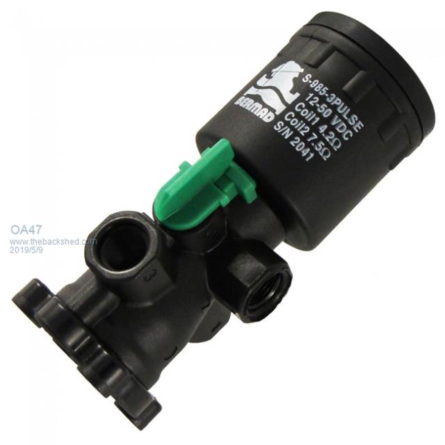

Here is a pic of the solenoids I have to control.

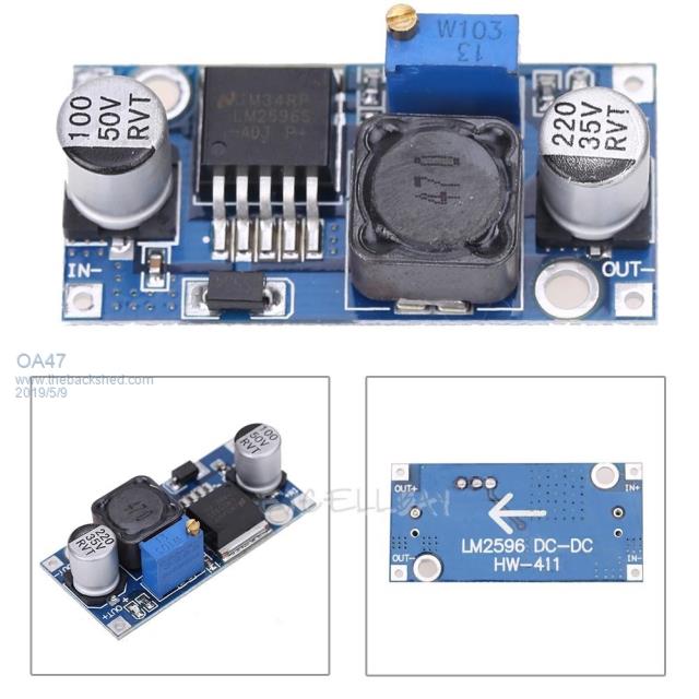

I thought originally that I could use these LM2596 units but it seems they cannot boost voltage.

I've used lots of those LM2596 modules, and they work well, but are a buck-converter, and the input voltage has to be larger then the wanted output - pretty much like any standard linear regulator.
No, they cannot boost.

Here is a schematic of the module:
As you can see, they have made the multi-turn trimmer R1, and the issue you have with this arrangement, is that if you apply - say - 12v to the input, and the trimmer is up near the positive output end of it's travel, when you switch on the juice, the supply voltage flows into the trimmer via the 22uH inductor and the Schottky diode. with the wiper of the trimmer up too far towards the positive end, this puts a potential of much more then 6v on the FB pin, and the device catastrophically fails due to breakdown of the FB pin input. The FB input is probably nothing much more then a gate junction internally, and just like any other MOSFET gate, if you exceed the maximum gate voltage.....Bang!
With a different schematic layout, this chip would work fine with higher input voltages, but the way they have designed the module, if your input voltage is more then 6v, and you turn the trimmer up too far, it is fatal for the device. The design needs refinement for use as an adjustable boost converter, as it is not very foolproof the way they have made them.
The datasheet gives the formula to calculate the output voltage from R1 and R2, but they are expecting you to use set resistors for R1 and R2, NOT an adjustable resistor for R1 - that is where the design falls over a little.

it looks like you are driving a water valve, with two separate coils - one to turn on the valve, the other to turn it off. just had a look at the datasheet for a IR-S-985-3W, which i presume is very similar.
i'd be using the full 50v (or as close as possible), as the energy stored in a capacitor is (C x V^2) / 2 where C is the capacity in farads. so going from 18v to 36v gives you four times the stored energy, going from 18v to 50v gives you nearly eight times the stored energy.
