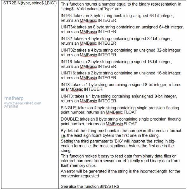

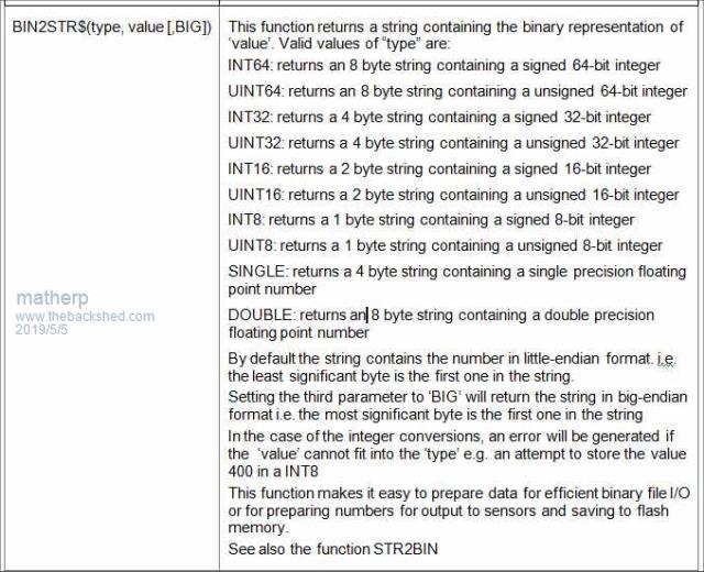

Working with Geoff, and coming soon to all versions of MMBasic, two useful new functions have been created. These make it easy to save and load binary data from file and convert data to and from sensors like the BMP180 family. For File I/O the size of data saved can be easily tuned to match the requirement ensuring file sizes are kept to a minimum. The functions also make it easy to work with things like flash memory chips more efficiently than with ascii data.
Test program attached
