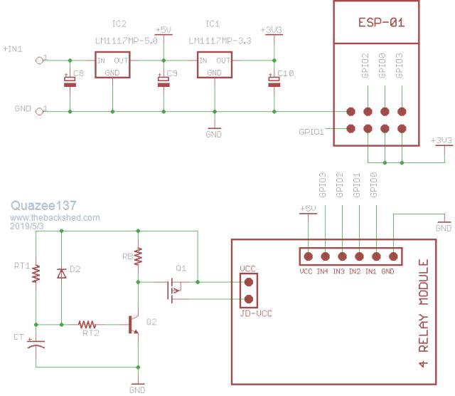

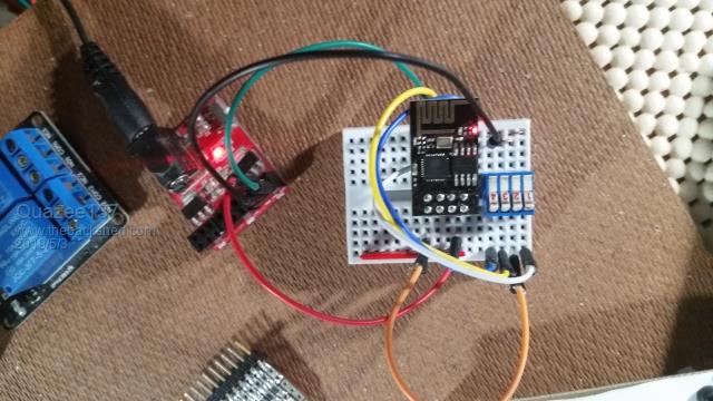

The ESP-07 and 12's are easy to get the 4 relays working. While
waiting for my burner for them (very slow boat from CHINA).
I went back to play with the ESP-01's. I found out that you can
turn off serial port freeing up Tx = GPIO 1, Rx = GPIO 3 now I
can use them to drive the relays. Well except the startup chatter
will fire off GPIO1. Not good !!! But wait what if the relays had
a slow start function. Then the ESP-01 can power up and not affect
them. So here is the basic concept.

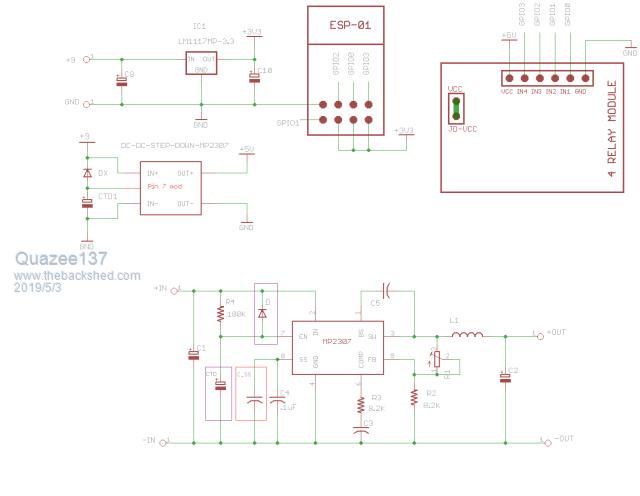

I liked the circuit from Grogster post Grogsters post
I remembered seeing this post Grogsters post while looking for the other one.

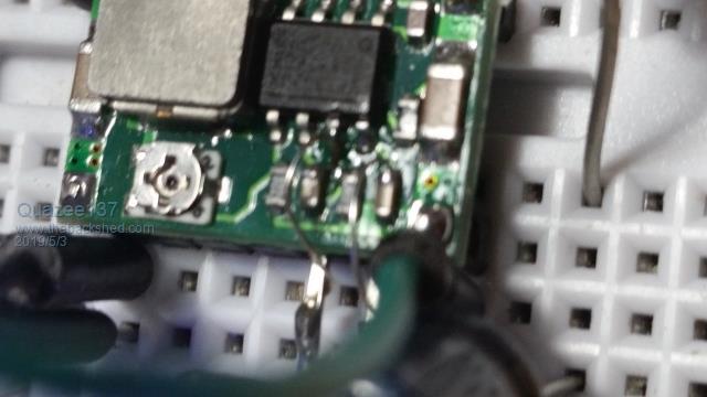

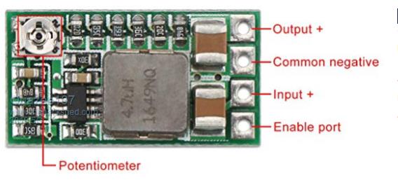

Had 10 of them I got to top off and order (free shipping LOL). Looking at the
MP2307 data sheet I saw that there is two pins of intrest 7 (EN) and 8 (SS).
Getting these out to play with was 20 min's of hit and misses but got them.
First played with pin 8 but even with a big cap not as much time for the
ESP-01 to get settled. So on to pin 7 and the works with adding Diode and
220uF cap now a few sec's delay while the ESP-01 powers up.
and the sender is so simple
To make this easier there are these modules
5 on order to play with.

And after thought on using the 4 bit level shifter one could hold the 3.3v at
bay for a few sec's may work for both input and output delaying.

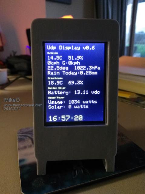

I also have been playing around with Annex. Seems to work very well. I recently updated all my remote sensors that had ESP8266 with ESPeasy firmware and for most cases was all I needed to read most sensors. the ESPeasy also works great wifi is no longer a problem with loosing comms as the ESPeasy manages to reconnect with no problems. I just have one esp8266/micromite (mx170) combination where the mx170 decodes the data stream from a wind sensor and the ESPpeasy sends the data via UDP with the data coded in json.
I have a Node-mcu module running Annex as a tiny data monitor. the Annex software decodes the UDP data and displays it on a 2.8" SPI LCD display. This is a very simple setup and I was surprised how simple it was to code and so far it seems bullet proof.
