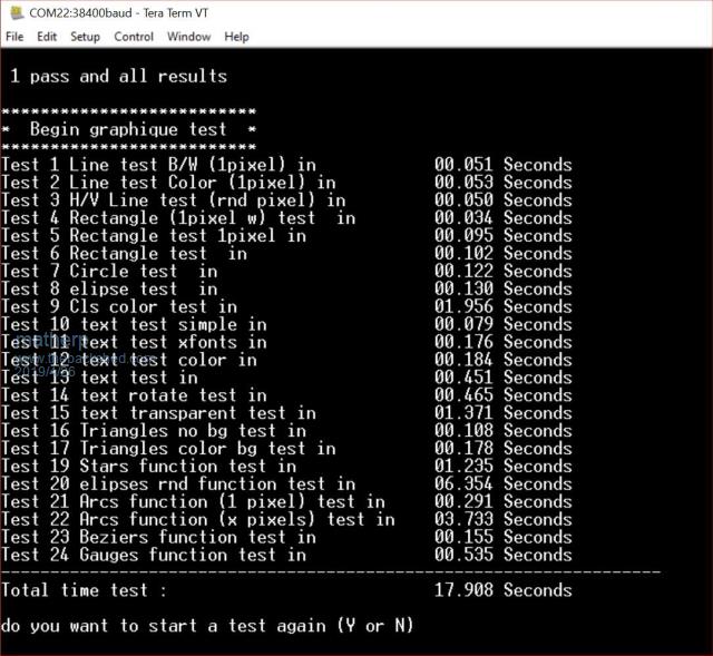

Minor tweak to the program to cater for the Armmite F4
2019-04-26_040040_test_graf_v01c.zip
and here are the results on the direct attach ILI9341 (16-bit parallel)
Watch the video
