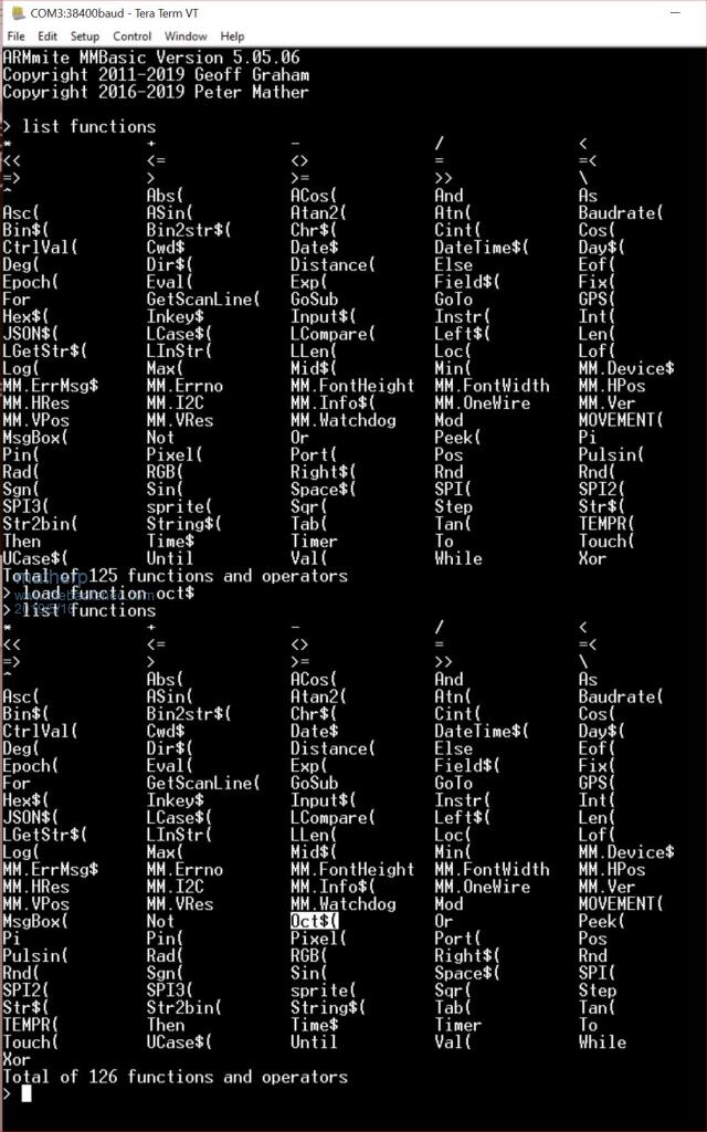

LIST COMMANDS will list all valid ArmmiteH7 commands
LIST FUNCTIONS will list all valid ArmmiteH7 functions and operators

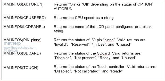

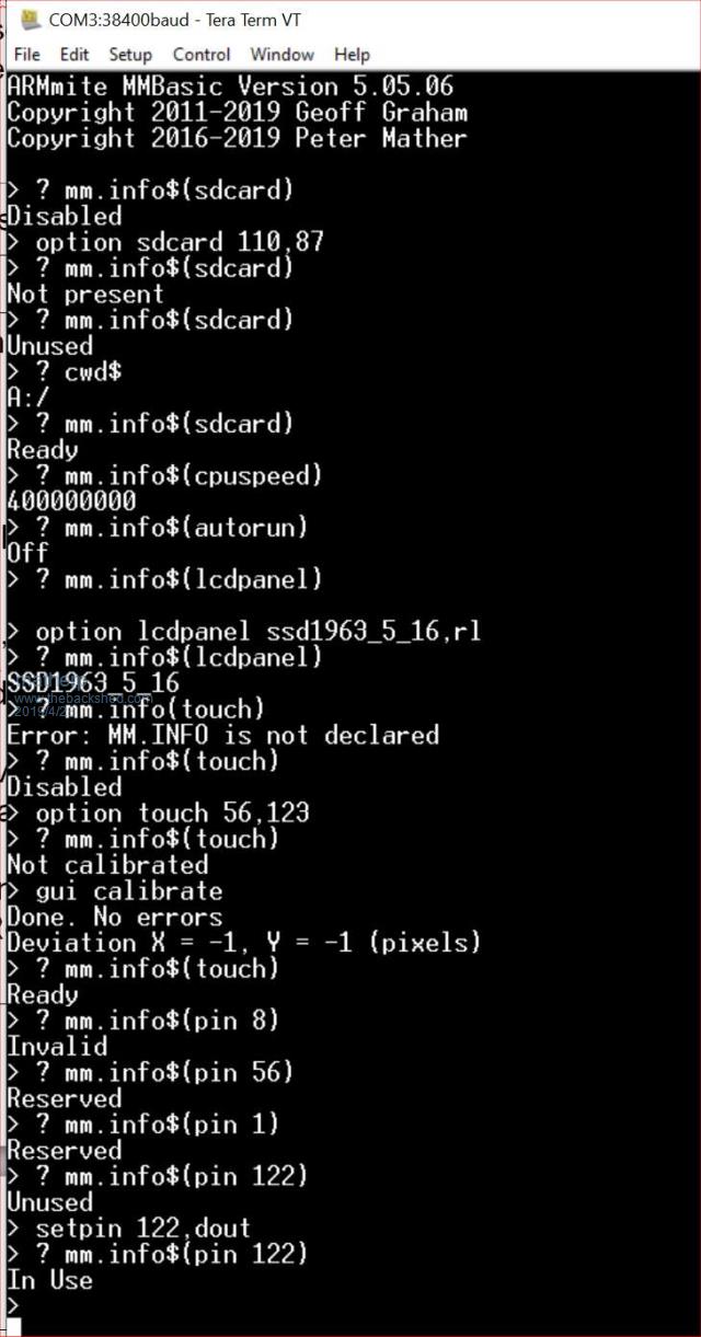

Minor addition of an information function. I'll add this to other ports as and when.
This also fixes a number of issues that occurred when a user defined function was called in the conditional test of a DO WHILE loop or in the parameters of a FOR-NEXT loop - thanks to Geoff for this fix.
