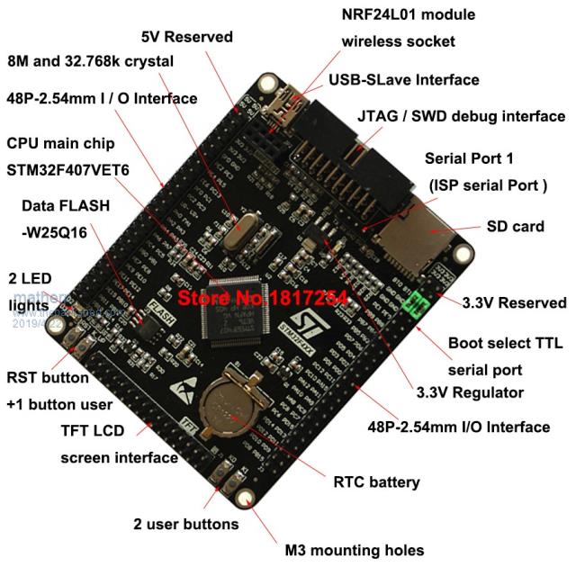

Various comments over the last weeks and months have emphasised the barrier that soldering SMD chips creates and whilst ready-built Micromite boards are available they are comparatively expensive. PCBs like the STM32 Nucleo range are cheap but they do not have SDcard slots or batteries for the RTC. They also don't easily interface to a display.

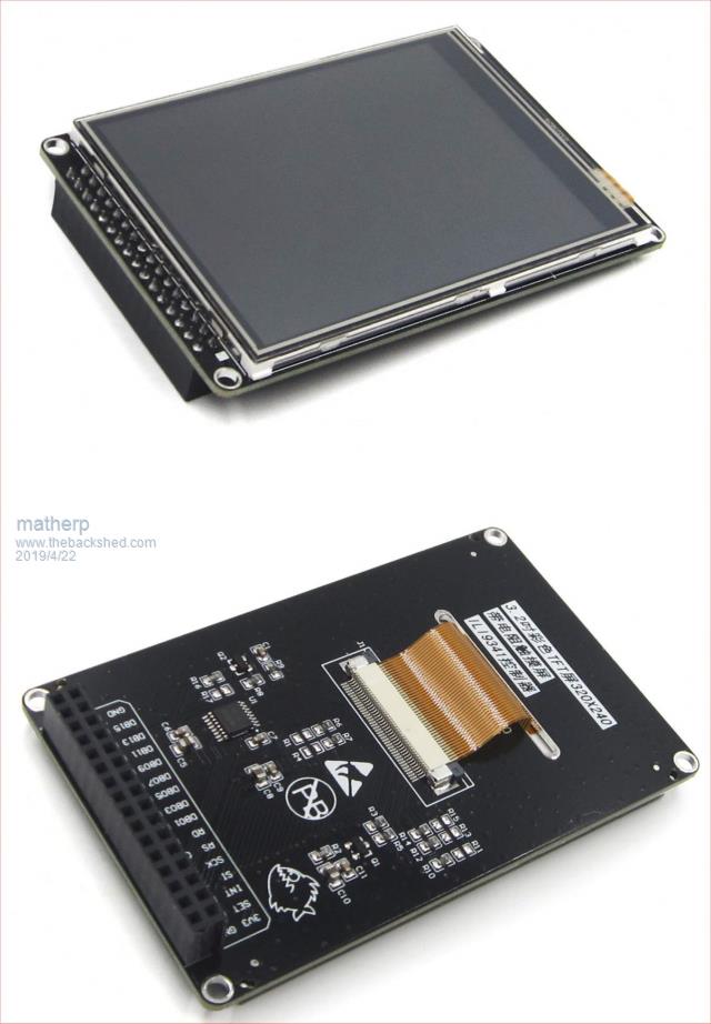

Enter the STM32F407VET6 STM32 Cortex-M4 Development Board
which has a pin compatible TFT screen available to plug directly in.
Together, the PCB and screen are currently available from the link at US $9.24 for the PCB and US $13.2 for the screen and they are available from various suppliers in huge numbers (stock level currently 29000 PCB and 14000 screens)

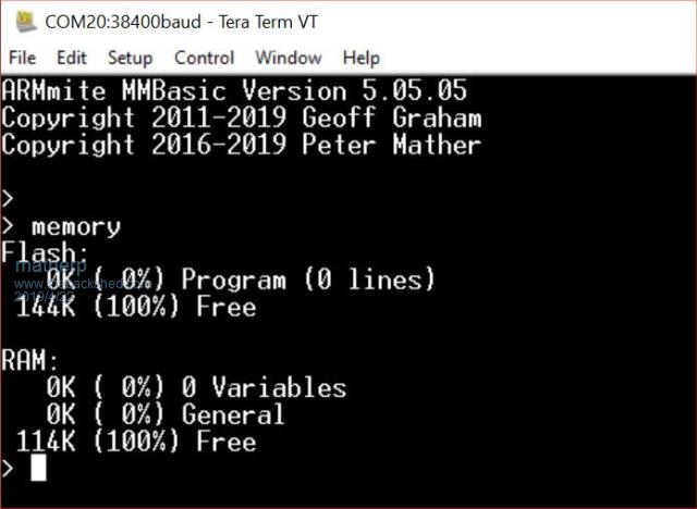

I'm in the last stages of developing a Micromite firmware version which will work on this PCB with no configuration necessary and no ancillary hardware needed. i.e. the main peripherals will work immediately on power up.
The firmware can be loaded to the board over the USB port with no programmer needed and the Micromite console will be on the USB, no USB/UART needed.
The speed of the port is about 1.3x faster than a MM+ at 120MHz. Peripherals include 4 x UART, 2 x SPI, 8 x PWM/Servo, 2 x I2C, 13 x 12-bit ADC, 2 x 12-bit DAC, 16-bit parallel TFT I/F supporting the screen above and any SSD1963 display using an adapter board.
There are 47 user configurable pins (DOUT, DIN, etc.) and these can be referred to with either the pin number or the pin ID as silkscreened on the board.

At the moment I'm doing normal bird's nest development on another PCB but once my purchases arrive I'll do a dedicated manual for this port.
The firmware uses a completely new (to me) way of interfacing with the TFT screens using the STM32F407's FSMC interface. This treats the screen as a memory device and allows for very fast performance (clear screen on the ILI9341 currently takes 6 mSec). Touch is of course supported with full GUI functionality.
As I understand more about the STM32 range and its development environment this new port shares about 95% of the code with the Armmite H7 and Armmite F7 making ongoing support much easier.

Very, very cool but quick question:
The 6ms screen clear, does that hold up program execution?

I confess to being one of those daunted by the idea of soldering large surface mount chips (and cheap, too).
This looks like just the ticket. Is it a 144-pinner?

Posted: 05:57pm 21 Apr 2019
  Quote  The 6ms screen clear, does that hold up program execution?
Yes, same as all of the Micromite family, drawing commands are all blocking. If I had a frame buffer the size of the display then I could DMA in the background but this would need more memory than available.
  Quote  This looks like just the ticket. Is it a 144-pinner?
No: 100-pins. Will run on STM32F407VET6 or STM32F407VGT6. There is a 144-pin version of the PCB: e.g. which could be supported but it is more expensive and no real advantage.Edited by matherp 2019-04-23

In case the schematic is a bit hard to read I think it's the same as the one
here

Getting back on track - this new STM32 board looks great and great value - I'm going to have to get one and get into STM's. The only 'pick' I have is that the screen they're selling is a bit small so as Grogs says, guess we'll need an adapter. Will we be able to go to say a 4.3" 480x272 1963 type display?

  Quote  The only 'pick' I have is that the screen they're selling is a bit small so as Grogs says, guess we'll need an adapter. Will we be able to go to say a 4.3" 480x272 1963 type display?
I've done an adapter and the gerbers are with WW who is going to get some with his next order - I'll post them when delivered/tested. 480x272 1963 type display has been tested on wires and works nicely.
