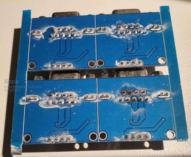

I purchased some "MAX3232 RS232 Serial Port To TTL Converter Module Female DB9 COM Serial MAX232" on ebay the units look OK until you turn over the circuit board.
What is the best way to clean them and stop the potential corrosion?

I use a cotton (must not be man-made, and don't use those with plastic sticks) ball in snipe-nosed pliers dipped in DiChloroMethane (DCM) first - it will dissolve most things (you might try Acetone if you have no DCM). Scrub to remove all the crap. Do this is a well ventilated place, the DCM evaporates quickly and there is some suggestion the vapour can be carcinogenic (!)
Then a wash in 50/50 IsoPropylAlcohol/Distilled Water and scrub with a nail brush.
Leave to dry in an oven at 60C for two hours, or in the sunshine on an outside ledge (for those lucky enough to have it) for a day.
works for me, but those boards are badly contaminated.
When dry, consider dusting with a lacquer or penetrating oil (WD40) - dependent on where they are going after.
my 2p

I've received a few dirty ones and just scrub the dirty area with an old toothbrush and straight isopropyl alcohol. You can get the IPA at Bunnings in the paintshop section. Give it a good shake after you've scrubbed it and there's still IPA on it, it evaporates quickly. Then give it a bit of a blow and check how it looks. If it's still dirty repeat the process.

Hi, I'm dedicated to repairing electronic cards, and for years I use good quality thinner, since it evaporates quickly and is not a driver, I use a toothbrush and that's it. If you are going to use them in an area with high humidity, say the coast, the bathroom with a clear varnish and finally a bath of WD40

Decades ago Tektronix had a standard method for repairing oscilloscopes ... they dunked them in soapy water in a bathtub! After a few hours soaking they treated them to a warm water shower or a second soak in clear water then a day or so in an oven at 120°F which would evaporate all of the water absorbed by the ceramic insulators.
Water is the universal solvent and it evaporates completely in a warm oven. If there's any gunk left after a day at the spa you can resorts to solvents like alcohol, freon, lacquer thinner, DCM, MEK or the like but it usually won't be necessary.
At Pan Am we found that organic stuff (burned flux) would often be trapped under a dipped layer of varnish. We would first strip the varnish with a solvent then proceed to the bathtub followed by the oven. It was always amazing to me how many filthy boards were passed by all the MIL spec quality control measures at Bendix, ITT Federal, Collins, Boeing, Douglas et al.

Wow!, Those boards are disgraceful, I cant say I have ever bought any quite as bad as those before..
They look as though they have also been chewed by wild dogs...
That aside, all of the boards that I make for sale (or own use for that matter) I clean with a spray on flux remover and an old toothbrush.. It dissolves flux like magic..
It does feel sticky after its clean but dries quite well after 30min or so at room temp. I then pop them in little plastic bags before shipping.
If you need to use them in `rough’ environs then you can spray with a Conformal Coat spray, I last used one that was an electrolube product about 30 years ago.. I assume RS Components or E14 would stock them..
There are MANY different types of Conformal coatings so chose the one best for your use

I would also consider resoldering those joints (remove the old solder first) as they could possibly be contaminated..

Isopropyl and an anti-static tooth-brush - spray, scrub, scrub, scrub, blow down with air-wick(compressed air in a can). Done. I don't know what the hell kind of solder some of these factories are using, but the residue from it it amazingly dirty.

they are using a lead-free, no-clean manufacturing process. supposedly the residue you see is electrically inert and water soluble. but from china who knows, and even if it is inert it can still provide a home for atmospheric contaminants in the field.
btw, one thing to be careful of when reflowing lead-free solder is creating a mixture of leaded and lead-free. essentially you can end up with an unknown alloy that may have poor electrical and/or mechanical properties. i usually flood the joint with leaded solder, then remove everything with solderwick, finally resoldering with leaded solder. although not a perfect solution, it seems to work well.
i hate lead-free solder.

Looks like water damage, especially the one bottom right.
This layout doen't seem very critical (no thin traces) you can take the risk of damaging the solder resist and but keep the copper on. So: toothbrush(electric?) and toothpaste. Give it a through rinse.
Then (after drying) try to resolder the bad spots, especially if you expect internal contact to be bad (surface does not always show whats underneath).
Then a bit of clear spraypaint as protective.

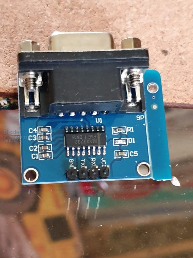

But important question is: how does the other side look. Are the MAX232's in good shape, or is it just as bad there. I once had boards where corrosion at the SMT parts was so bad it was beyond repair.

Here is an image of the other side, NOT the same one though.
