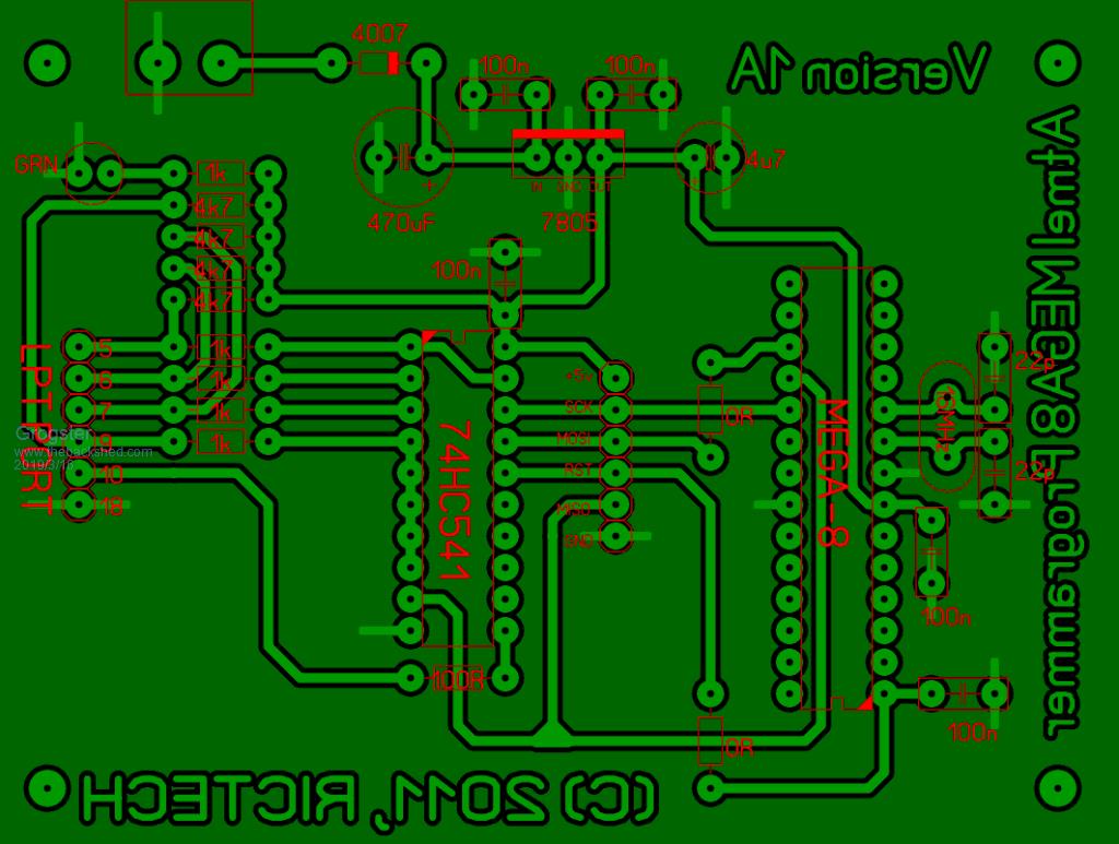

EDIT: I found the PCB pattern for the MEGA8 programmer from eight years ago:
This was single-layer, and eight years ago, so it is not as neat as my recent designs.
It obviously worked from the printer port. I have no idea now what application that would have been, but I suspect it was a 3rd party programmer and software. I would not have designed this circuit, I would have found it on the net and just done the layout for it.
I wonder what LPT software programmer I would have been using?
Anyone got any ideas?Edited by Grogster 2019-03-17

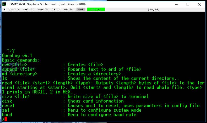

now have verstion 4.2 of the OpenLog firmware compiled and loaded onto one of the boards - it seems to work pretty well, though have only done quite limited testing just through a terminal emulator and at only 9600 baud. documentation is a tad sparse to say the least, but then the number of commands is quite limited.
is anyone else interested in tinkering with OpenLog? if so, i'll attempt to put together a bit of a guide on getting a blank units that lacks even the bootloader fully up and running.
