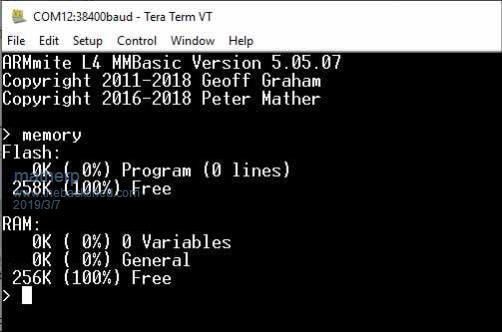

I did some more testing on the Nucleo-L476 and discovered that analogue input wasn't working using the Armmite-L4 firmware. It transpires that the analogue setup on the L476 is sufficiently different from the L433/432/431 to require compiling with the chip specific libraries.

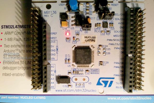

I can't test the L476 anymore as my Nucleo has undergone a heart transplant and is now the mythical Nucleo-L496 (64-pin variant). Much more memory
2019-03-07_031232_ArmmiteL476.zip
If you have an unmodified Nucleo-L476 please could you give the above firmware a quick checkout - particularly the various special function pins (analogue, i2c, spi, etc.)

Do I take it from your picture, you have just lifted the 476 and replaced it with a 496 on the nucleo~l476rg board?
panky
Posts: 12084
Posted: 12:17pm 07 Mar 2019
  Quote  Do I take it from your picture, you have just lifted the 476 and replaced it with a 496 on the nucleo~l476rg board?
Yes - hot air gun carefully applied until the existing solder softens (unleaded unfortunately so quite hot). Remove existing chip, clean pads with solder wick, then solder the new STM32L496RGT6 chip in place.
