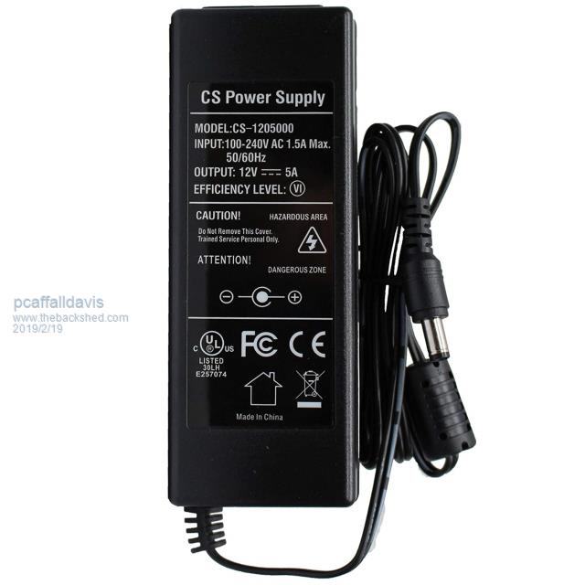

I guess I should specify what I mean by computer type desktop power supplies. I mean the type that often come with laptop and tablet computers; like the one in the photo below. So how do I make sure I don't get more noisy ones with lots of EMF interference when I order a new 12 V 5 amp and a new 24 V 5 amp unit? Is there a better type power supply than switch-mode? Or is it just trial and error? How do I tell if the one in the picture is switch-mode?

Any power supply that specifies an input range of 100 to 240 v ac is undoubtedly a switcher. You probably need an old fashioned stepdown transformer, a full wave diode rectifier, a capacative input filter, a linear regulator, and a final capacative filter. It will be more expensive and a lot heavier. You might save a little if you build your own.
