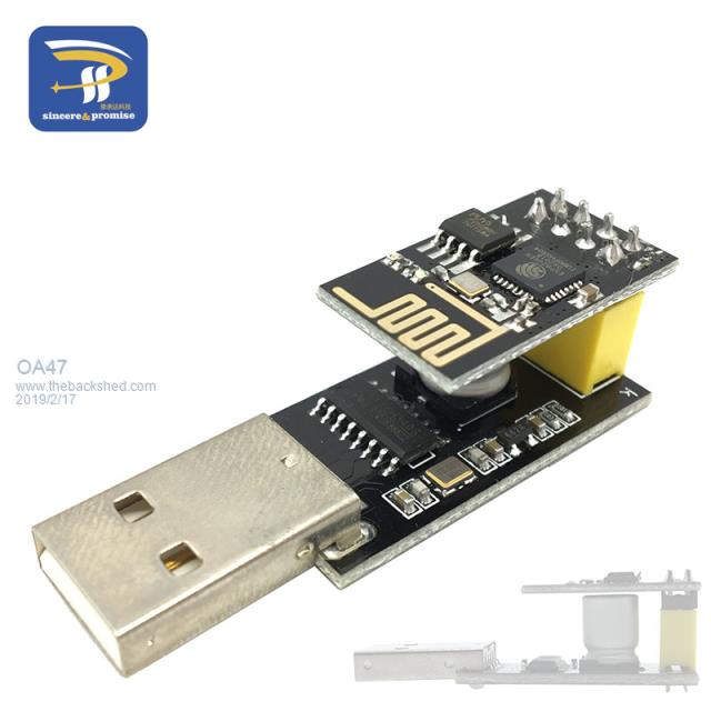

I purchased some ESP and Serial-USB converters as shown.

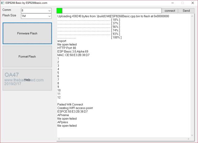

The first thing I did was to upgrade the ESP unit with ESP-Basic v3 and this all went ok.

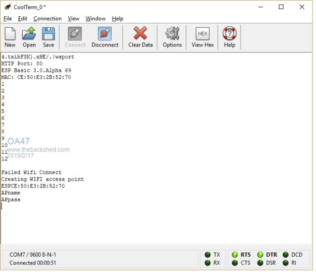

The units boot up with the following messages on the terminal program.
I can log onto the ESP WiFi without any problems.

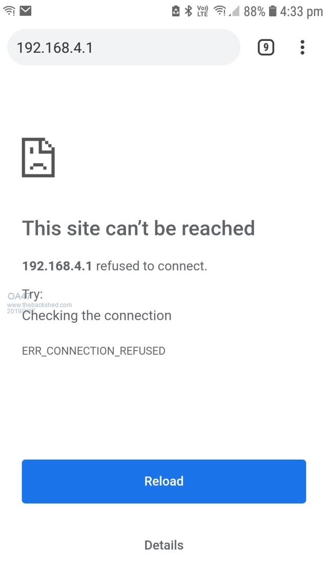

Before I can update the ESP with logon details and ESPBasic code I need to be able to reliably connect to the pages. Occasionally I can get the main page up (But very occassionaly) and if I do I cannot navigate to the SETTINGS or EDIT pages. I have tried 3 different android devices and get the same result. Can anyone assist with where I am going wrong?

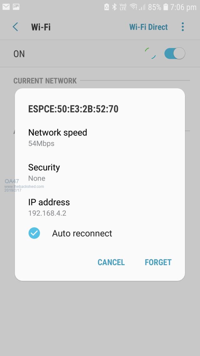

Thanks for the reply CYBERLAB. I am connecting to the access point mode of the ESP8266 as the android screen shot shows "Current Network ESPCE:50:E3:2B:52:70" and it is awarding the IP address of 192.168.4.2 to the android device.

  Quote  once the connection is done open your internet browser and in the address bar use the ip address by default: 192.168.4.1
The issue I have is that I cannot bring up the page 192.168.4.1 to configure the ESP8266.

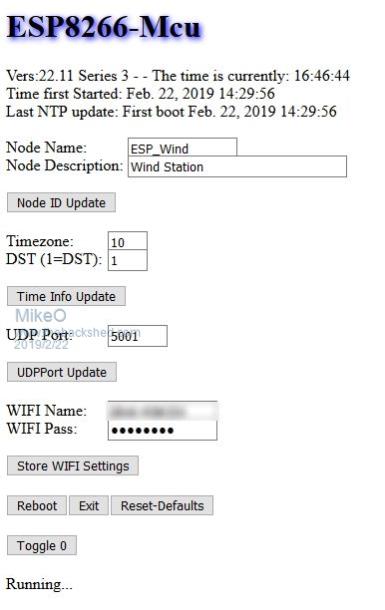

Setting up ESPbasic successfully on a ESP8266 module can be a little challenging sometimes.
In order to help out one of our forum members I found that my documentation for this process was sadly lacking and mostly "in my head" so I have gathered the tools together , created a pdf describing the process and even made a few more code changes to my ESP8266-MCU library for the module. I have updated my web page so if anyone would like to have a go please visit here for the information.
The ESP8266-MCU does not need a uMite to be connected, has its own UI and could be used as the basis for your own application.
