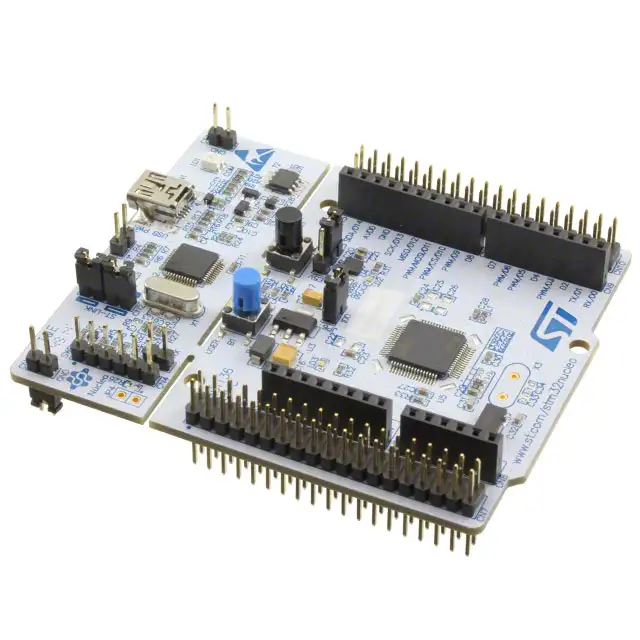

1) Make sure you have a NUCLEO STM32L476 board
https://www.st.com/en/evaluation-tools/nucleo-l476rg.html
https://www.digikey.com/product-detail/en/stmicroelectronics/NUCLEO-L476RG/497-15881-ND/5347711

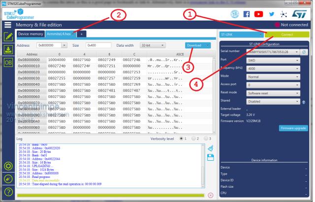

Open the STM32Cubeprogrammer
(1) click the 'connect' button top right to connect to the board
(2) click the 'open file' tab and select the image file ( i used the .HEX file provided in the distribution )
(3) click the Download button and wait for programming to complete.
(4) click the disconnect button top right ( same as the connect button )

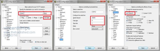

6) Find out to which com port the board has attached itself.
Open device manager (windows) and under 'ports COM & LPT' look for STMicroelectronics STLINK Virtual COM port. Mine was COM12
Fire up Putty ( or your preferred terminal program. )
Connect using the COM port you found, 34800 as baudrate , no parity , 8 databits , 1 stop bit : 34800,n,8,1
It is important to set up the backspace character correctly to CTRL-H for the command line to be editable.
in the above image i have set my com port (COM12) , serial connection , 38400,8,1 and the Control-H character for backspace. You can save this to Putty Defaults, or a custom setup file so you don't have to do this every time
7) hit the reset button on the nucleo board and you should be greeted by the Copyright messages and a prompt.

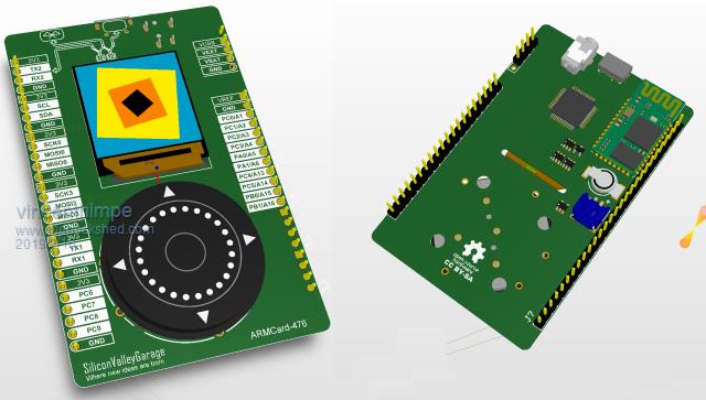

I know it is cutting edge : but i am designing a PCB for it and need to know certain hard information so i don't have to respin the board. i don't like tinkering with breadboards , nucleo's arduino's and what not. Those boards are invariable of poor quality , badly documented and missing lots of features.
Edited by vincenthimpe 2019-02-17
Posts: 12085
Posted: 07:13pm 15 Feb 2019
This is the schematic for my Backpack PCB - fully tested and working
2019-02-16_051249_HAT64_-_Schematic.pdf
vincenthimpe
Joined: 14/10/2018
Posts: 86
Posted: 07:49pm 15 Feb 2019
yes, i found that one. But i'm running on a 476 in 64 pin, not a 432 in 48 pins
So the questions still are : can the flash and display be moved to a different SPi port ? you run spi2 , i want to run those on spi 3
Are is PB2 controllable ?
what about ports D2 H0 and H1 ?
-edit- found ports h in the updated pinmap.
https://www.thebackshed.com/forum/forum_posts.asp?TID=10967&PN=1
Sorry if i ask a lot or sound a bit cranky but the documentation is so scattered over various topics with often conflicting information ...
specs of what i am building
- credit card size
- L476 based
- usb or 5v power source
- cp2010 usb/uart
- protected usb port
- liion charging with programmble charge currents ( different for usb or external 5v)
- rtc backup (supercap)
- switching regulator for 3.3v
- precision 2.048 volt reference for adc, so no muckery with floating point
- st7789 display
- navigation pad ( up/down.left/right with rotary encoder and select )
- 3 user buttons
- spare footprints for a number of sensors ( Bosh: temp,hygro,pressure,voc and gyro/acc)
- protected i2c port with proper level shifting and bus isolation (i2c port is split in 2 banks : 1 for on-board stuff , 1 for external stuff )
- footprint for BLuetooth uart (switchable usb/bluetooth) on console port
- all remaining io pins properly labeled at the edge of the board on 0.1 pitch

vincenthimpe
Joined: 14/10/2018
Posts: 86
Posted: 07:25am 16 Feb 2019
to give an idea where this is headed :
Posted: 01:40pm 16 Feb 2019
Ah, I thought you were looking at doing a Nucleo-L4 64-pin backpack. Keep us posted.

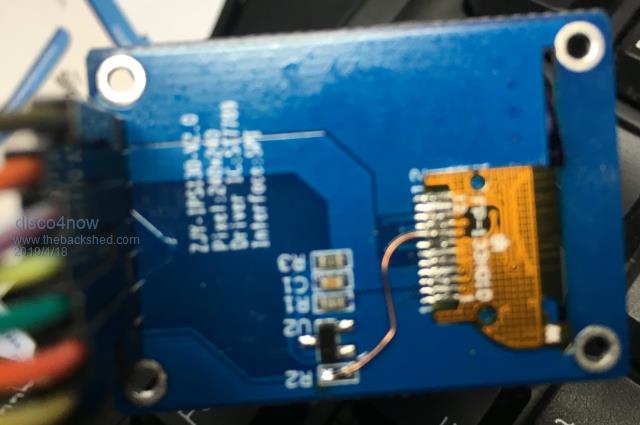

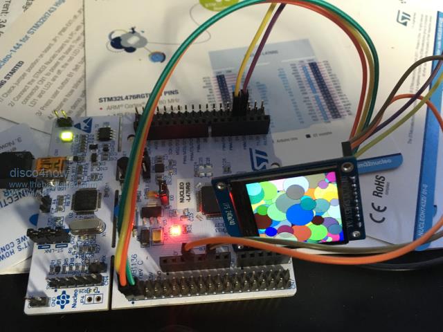

I have one of these ST7789 clones that comes without the CS pin exposed. I have the source for Peter's driver for the MM2 and MM+ but have not been able to get it to go as is , i.e. with CS permanently selected on the board. Apparently when they work with Arduino, they use SPI mode 3 but I have no success. In the end I modified it to expose the CS pin in lieu of the BLK pin.
After the modification it works on the Nucleo L476RG (l4 64 pins) with MMBasic set up as you have it.i.e.
OPTION LCDPANEL ST7789, LANDSCAPE, 51, 53, 52
ARMmite L4 MMBasic Version 5.05.09
Here is my modification:
1. Remove R2
2. Pin 8 of the ribbon is CS, it is connected to GND on the PCB but under the ribbon.
I used a heat gun and lifted the ribbon, then cut the track at the base of pin 8 on the PCB, checking it was no longer connected to ground.
3. Put the ribbon back
4. Run a small wire from pin 8 to the R2 pad that goes to the BLK pin.
5. BLK is now gone and is now CS.
The bit you may not have done is remove the permanent GND on CS, this seems to stop it working, the GND being applied by CS is what triggers the initialisation.
GerryEdited by disco4now 2019-04-19
F4 H7FotSF4xGT
Posted: 09:46am 18 Apr 2019
excellent work

  disco4now said   Hi,
1. Remove R2
Gerry
