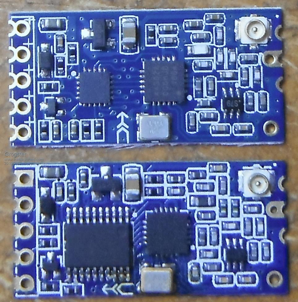

Hi all.
These are the latest module from hc01.
The new one is on the top, the old one is on the bottom.
Both the old and the new operate exactly the same, as you would expect - and are perfectly on frequency.
The most obvious change is that the SSOP has been changed for a QFN package.
This does, however, make it very easy to now spot the difference between the old and the new models, and genuine ones will have the QFN package on them - for now, until the cloners clone the latest model. I would expect that to take a little time though, so for right now....
RossW helped me get this batch, so my thanks to him.
Posted: 12:16am 13 Feb 2019
I see the new one has some more caps probably for decoupling. The QFN version might be a bit more reliable.

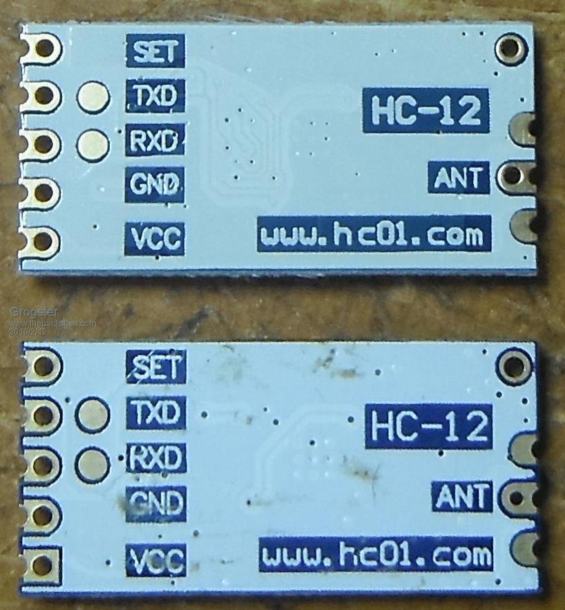

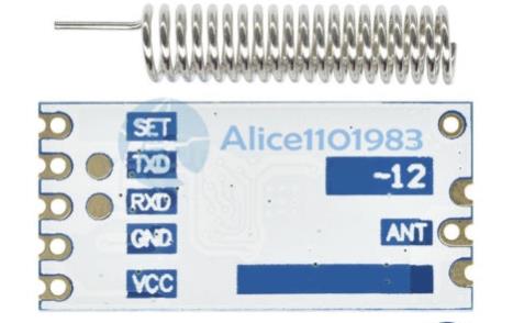

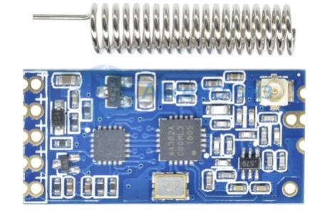

Looks like the clones are already out there.
front view
back view
Posted: 01:13pm 15 Feb 2019
great
Posts: 10081
Posted: 04:02am 16 Feb 2019
Damn. I was not expecting them that quickly. The only way you can be sure, is to test each and every one for frequency accuracy, or buy direct from hc01 or the resellers.

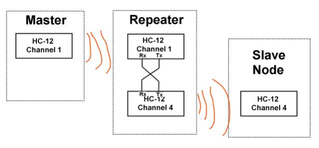

If you want to reach devices beyond range, you could do it transparently by having HC-12s back-to-back but on different channels... a small repeater would consist of two HC-12's and a PSU, nothing more. On the master end you could be, say, on channel 1 and the remote would be on say, channel 4. The two HC-12s would have their Rx/Tx lines crossed over and one on each channel. There would be a tiny delay introduced but that would work.
Would 2 miles of reach solve your problem? A star network is very much simpler to do. Similar blind spots would need a repeater but set the slave and secondary in the repeater to a different channel say 8 for good separation. Transmission windows (master -> slave, wait for reply etc...) would need to be opened out a tiny bit to allow for the relay to do its thing.
Although the repeater could be implemented with laughable simplicity, I might be tempted to put a micro-controller between them and relay through it because then you could make a standard unit with some switches on the outside to set the channels and the controller would read those and send the relevant AT codes to the HC-12s to alter their settings... but only if I wanted the repeater to be a standard unit I could drop in anywhere in any number... if I needed just a handful, it would be exactly as shown above. No point going to manufacture on just a tiny run that is easily achieved without it.
