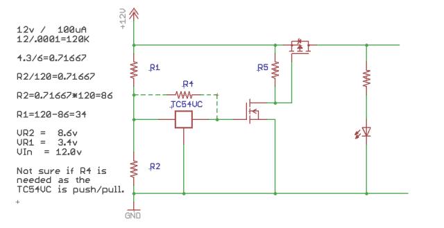

Try this basic concept gleamed from Low-battery monitor with TC54 voltage detector
Posted: 04:58pm 11 Feb 2019
That's a nice device - you can get them down to 1.4V so this will work nicely on battery controlled Mk2 running with a TC54VX21 which can be made to cut-out just above the minimum 2V.
good findEdited by CaptainBoing 2019-02-13
