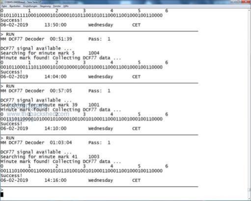

The code is well commented and tested.

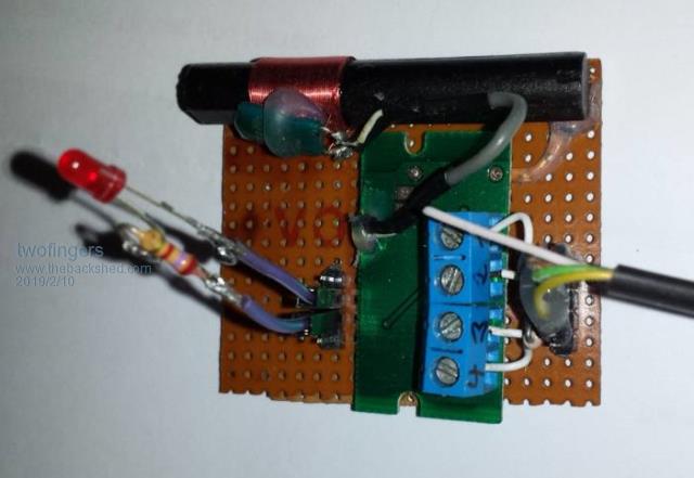

I used a very old (~30 years?) DCF77 module from Conrad Electronics in germany.
The red LED is pulsing at 1 Hz and indicates the DCF77 signal.
My module is connected to the MM2 with a 2m telephone cable.

'* f. Conrad-Modul
'* Pin1=GND Pin2=5V or 3.3V
'* Out=inverting output=Pin3 (connected to the MM with a 2m cable)
'* LED (+2.7k) from Pin3 to Pin2
'* to make the 1 Hz pulses visible
'* MM Input = DCFPIN

Print "MM DCF77 Decoder V1.0 "Time$, "Pass: "pass
Print
Timer=0
' Let's see if we have a 1000ms pulse (1 Hz) signal
' The interrupt does the job. tSec=time of one period of the 1 Hz DCF signall
Print "Waiting for 1 Hz Signal (1 cycle/1000ms) ",Str$(tSec,4)"ms";VT100_Cup$
Loop Until InRange(tSec,min_pw,max_pw)
' now we have probably a DCF77 signal
' Note: The better it matches the 1000 ms, the better the signal quality
Print VT100_Del$+"DCF77 signal available ... "
DCF_error=FALSE
Do '****************
If InRange(tSec,min_mmark,max_mmark) Then ' we found a 2000ms period
BitN=0:SyncOK=1:tSec=0
Print
Print "Minute mark found! Collecting DCF77 data ..."
Print "0 1 2 3 4 5 6 x10"
Print;
' Sub LoLevel does the job
If BitN=59 And SyncOK=1 Then ' seems we are complete
DCF_error = Not DCF77_readout()
Exit Do
If BitN >59 Then ' uff! No sync found. Let's start again ...
Print
Print "Error: Minute mark not found "
Exit Do
If DCF_error Then
Print
Print "Error: DCF_error (Signal)"
Exit Do
Loop While Not DCF_Time_OK'***** End Main Loop ******

Print "Success!"
Print DCF_date$,DCF_time$, weekday$, DST$(DCF(17)+1)
