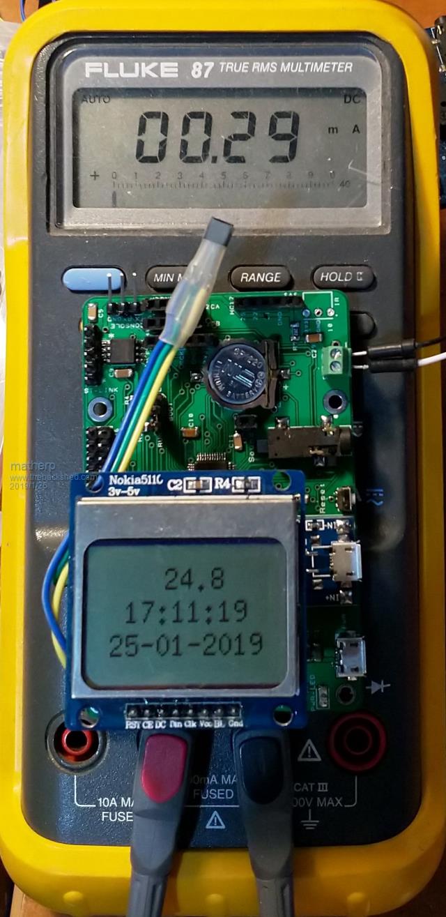

Now I've got a standalone PCB for the Armmite L4 I've been experimenting with low power battery operation.
This has revealed a numbers of interesting things:
In IR receiver takes 700uA when installed on the PCB
You can't measure supply power with anything else external and separately powered connected: Power usage went down from 290uA to 250uA when the USB/UART was connected, presumably through parasitic supply through the Console pins
Oled current is completely dependent on the number of pixels lit (obvious really) but the display pictured on an OLED would draw 10mA (30x greater)
Supply to the Winbond W25Q128 is negligible but I have included putting the chip to sleep when CPU SLEEP is operative
The battery charger/protection circuit causes no discernible current draw.
Choice of linear regulator is critical otherwise the quiescent current will be way above the current draw of the circuit (LT1117 = 10mA)
Given all of the above, my simple test environment pictured above should run for between 6 and 12 months on a single 3000mAh 18650 Lipo
