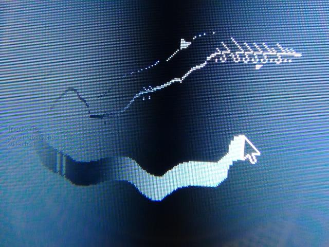

i am using OPTION MOUSE ENABLE on ILI9341 on MMX144 Ver 5.04.18
it is working nearly well but my mouse is dirty
someone try it ?
thanks
fred
Posts: 12084
Posted: 06:19pm 20 Jan 2019
Just tested works fine - You must have the MISO pin on the display connected as the driver reads the display memory in order to superimpose the mouse pointer
