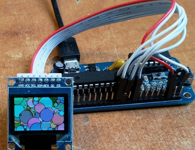

As requested by WW for MM2. Can compile for MM+ if anyone needs it.
NB: transparent text isn't possible as no MISO pin on display. I've included the 8x6 font as this is definitely needed for this display
Sub mm.startup
SSD1331 2,9,16, 1' DCpin, RESETpin, CSpin, orientation (1-4)

* Driver for SSD1331 Display written as CSUB
* (c) Peter Mather 2019 with acknowledgements to Peter Carnegie & Geoff Graham
* Also thanks to ADAfruit for the initialisation sequence
* This CSUB MUST be compiled with Optimization Level 1, -O1
* -O2,-O3,-Os will compile successfully, but generate exceptions at runtime.
* When Generating the CSUB, use MERGE CSUB mode, and name the CSUB
* SSD1331
* Entry point is function long long main(long long *DC,
* long long *RST,
* long long *CS
* long long *orientation)
* V1.0 2019-01-18 Peter Mather

//CFunction Driver_SSD1331
void main(long long *CD, long long *RST, long long *CS,long long *orientation){
volatile unsigned int libAddr ;
getFPC(NULL,&&getFPCLab,&libAddr) ; // warning can be ignored
getFPCLab: { }
int HorizontalRes=96,VerticalRes=64;
unsigned int consave=0,brgsave=0,con2save;
Option->LCD_Reset=*RST;
Option->LCD_CD=*CD;
Option->LCD_CS=*CS;
Option->DISPLAY_ORIENTATION=*orientation;
Option->DISPLAY_TYPE=20;
ExtCfg(Option->LCD_Reset,EXT_DIG_OUT,0);ExtCfg(Option->LCD_Reset,EXT_BOOT_RESERVED,0);
PinSetBit(Option->LCD_Reset, LATSET);
ExtCfg(Option->LCD_CD,EXT_DIG_OUT,0);ExtCfg(Option->LCD_CD,EXT_BOOT_RESERVED,0);
PinSetBit(Option->LCD_CD, LATSET);
ExtCfg(Option->LCD_CS,EXT_DIG_OUT,0);ExtCfg(Option->LCD_CS,EXT_BOOT_RESERVED,0);
PinSetBit(Option->LCD_CS, LATSET);
if(ExtCurrentConfig[SPI_OUT_PIN] == EXT_RESERVED) { //already open
brgsave=SPIBRG;
consave=SPICON;
con2save=SPICON2;
if(ExtCurrentConfig[SPI_OUT_PIN]!=EXT_BOOT_RESERVED){
ExtCfg(SPI_OUT_PIN, EXT_DIG_OUT, 0); ExtCfg(SPI_OUT_PIN, EXT_BOOT_RESERVED, 0);
ExtCfg(SPI_INP_PIN, EXT_DIG_IN, 0); ExtCfg(SPI_INP_PIN, EXT_BOOT_RESERVED, 0);
ExtCfg(SPI_CLK_PIN, EXT_DIG_OUT, 0); ExtCfg(SPI_CLK_PIN, EXT_BOOT_RESERVED, 0);
SPI_PPS_OPEN;
SPICON=0x8060;
SPIBRG=3;
SPICON2=0xC00;// this is defined in IOPorts.h
if(!brgsave){ //save my settings
brgsave=SPIBRG;
consave=SPICON;
con2save=SPICON2;
//Reset the SSD1331
PinSetBit(Option->LCD_Reset,LATSET);
uSec(10000);
PinSetBit(Option->LCD_Reset,LATCLR);
uSec(10000);
spi_write_command(SSD1331_CMD_DISPLAYOFF); // 0xAE
spi_write_command(SSD1331_CMD_SETREMAP); // 0xA0
if(Option->DISPLAY_ORIENTATION==1) spi_write_command(0x72);
else if(Option->DISPLAY_ORIENTATION==2) spi_write_command(0x63);
else if(Option->DISPLAY_ORIENTATION==3) spi_write_command(0x60);
else spi_write_command(0x71);
spi_write_command(SSD1331_CMD_STARTLINE); // 0xA1
spi_write_command(0x0);
spi_write_command(SSD1331_CMD_DISPLAYOFFSET); // 0xA2
spi_write_command(SSD1331_CMD_NORMALDISPLAY); // 0xA4
spi_write_command(SSD1331_CMD_SETMULTIPLEX); // 0xA8
spi_write_command(0x3F); // 0x3F 1/64 duty
spi_write_command(SSD1331_CMD_SETMASTER); // 0xAD
spi_write_command(0x8E);
spi_write_command(SSD1331_CMD_POWERMODE); // 0xB0
spi_write_command(0x0B);
spi_write_command(SSD1331_CMD_PRECHARGE); // 0xB1
spi_write_command(0x31);
spi_write_command(SSD1331_CMD_CLOCKDIV); // 0xB3
spi_write_command(0xF0); // 7:4 = Oscillator Frequency, 3:0 = CLK Div Ratio (A[3:0]+1 = 1..16)
spi_write_command(SSD1331_CMD_PRECHARGEA); // 0x8A
spi_write_command(0x64);
spi_write_command(SSD1331_CMD_PRECHARGEB); // 0x8B
spi_write_command(0x78);
spi_write_command(SSD1331_CMD_PRECHARGEA); // 0x8C
spi_write_command(SSD1331_CMD_PRECHARGELEVEL); // 0xBB
spi_write_command(0x3A);
spi_write_command(SSD1331_CMD_VCOMH); // 0xBE
spi_write_command(0x3E);
spi_write_command(SSD1331_CMD_MASTERCURRENT); // 0x87
spi_write_command(0x06);
spi_write_command(SSD1331_CMD_CONTRASTA); // 0x81
spi_write_command(0x91);
spi_write_command(SSD1331_CMD_CONTRASTB); // 0x82
spi_write_command(0x50);
spi_write_command(SSD1331_CMD_CONTRASTC); // 0x83
spi_write_command(0x7D);
spi_write_command(SSD1331_CMD_DISPLAYON); //--turn on oled panel
if(Option->DISPLAY_ORIENTATION&1){
HRes=HorizontalRes;
VRes=VerticalRes;
} else {
VRes=HorizontalRes;
HRes=VerticalRes;
//Set the DrawRectangle vector to point to our function
DrawRectangleVector= (unsigned int)&DrawRectangleSPI + libAddr;
//Set the DrawBitmap vector to point to our function
DrawBitmapVector=(unsigned int)&DrawBitmapSPI + libAddr;
#ifdef MX470
DrawBufferVector=(unsigned int)&DrawBufferSPI + libAddr;
#endif
//CLS
DrawRectangle(0,0,HRes-1,VRes-1,0x000000);
SPIBRG=brgsave; //restore user (or my) setup
SPICON=consave;
SPICON2=con2save;
static const char startup[]="SSD1331 driver loaded\r\n";
pstring(startup);
Edited by matherp 2019-01-19
