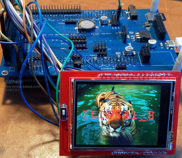

OK then
2019-01-21_015216_Armmite1.3.zip
2019-01-21_015833_Armmite_H7_Manual.pdf
OPTION LCDPANEL ILI9341_8, orientation
Selects 8-bit bus operation of the ILI9341 display. Pin usage is exactly as per the SSD1963. Pins SSD1963_DB8 to SSD1963_D15 are allocated but not used. Uses a memory resident framebuffer to improve performance.

Posted: 01:49pm 21 Jan 2019
  Quote  Will let you know should any bugs appear.
Shouldn't be bugs in the driver as just a clone of others
