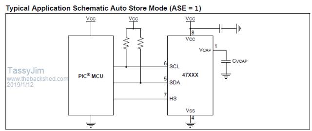

The 47L04/47C04/47L16/47C16 (47XXX) is a 4/16 Kbit SRAM with EEPROM backup. The device is organized
as 512 x 8 bits or 2,048 x 8 bits of memory, and utilizes the I2C serial interface.
The advantage over 'VAR SAVE' is
The SRAM won't wear out and the backup is fully automatic.
Once the control register is set, it saves the SRAM to EEPROM whenever power fails and restores when power returns.
It also retains data over program reload and even firmware updates.
It uses a ~6.8uF capacitor to give it time to act when power fails.
Cost is about $1
The disadvantage is, you need an extra chip and capacitors.
You may also be tying up the I2C buss a bit depending on how often you update the data.
I went with the 47L16 because it was available in DIP packages.
All the program does is read the data when the program first starts and the last saved data is there.
With a normal stop and restart of the program, the data stays in SRAM but with a power failure, it saves to EEPROM and restores again ready for retrieval.

If you force a save or retrieval, you have to allow time for the operation to complete. The time required depends on the chip used.

  TassyJim said  You may also be tying up the I2C buss a bit depending on how often you update the data.
Perhaps, but you could always use the I2C Cfunction to create a new dedicated I2C port just for the memory chip I suppose. That would free up the normal I2C channel(s).

One other point to remember is the time it takes to store and recall.
The 16k bit chip takes 25mS to store and 5mS to recall.
Storing shouldn't matter as it would happen after power fail but if you had autorun set, you should pause 5mS at the start of your program to give the chip time to get the SRAM back with it's saved data.
The 4k chip has shorter times.
You can also set a portion of the memory as protected so semi permanent settings are safe from overwrites.
