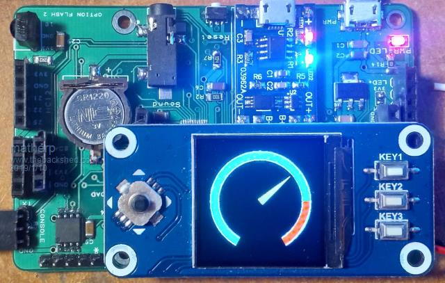

Please find attached version 5.05.05 for the Armmite L4
2019-01-10_204755_ArmmiteL4.zip
This includes the following changes:
Added triangle command with array support - see H7 manual for syntax
Added ARC command - see H7 manual for syntax
Added Bezier command - see H7 manual for syntax
Added support for ST7789 display as in pictures
OPTION LCDPANEL ST7789, orientation, DCpin, RESETpin, CSpin
Added support for ST7735S display as per recent CFunction. NB: there appear to be two variants of this. I'll add support for the second variant when I have confirmed the initialisation differences
OPTION LCDPANEL ST7735S, orientation, DCpin, RESETpin, CSpin
Final decision to run single precision floating point on the L4. This saves a huge amount of flash memory for additional features and is faster. Applications that need double precision should use an alternative platform.
The triangle command is highly optimised when outputting to colour displays in order to allow flicker free updates to the screen as per the video
As there were reported issues I have bought a couple of HTU21D sensors and can confirm they work perfectly for me on the Armmite L4 using TassyJim's code
Video of demo code

Arc MM.HRes\2,MM.VRes\2,99,101,210,150
Arc MM.HRes\2,MM.VRes\2,84,86,210,150
Arc MM.HRes\2,MM.VRes\2,86,99,210,90,RGB(green)
Arc MM.HRes\2,MM.VRes\2,86,99,90,150,RGB(red)
