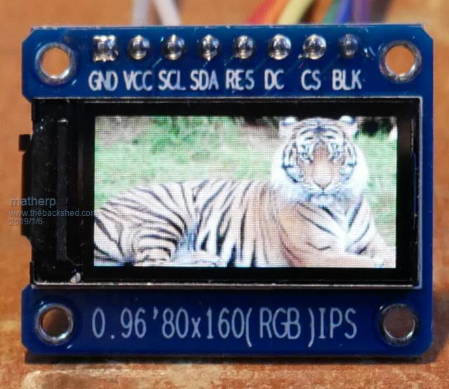

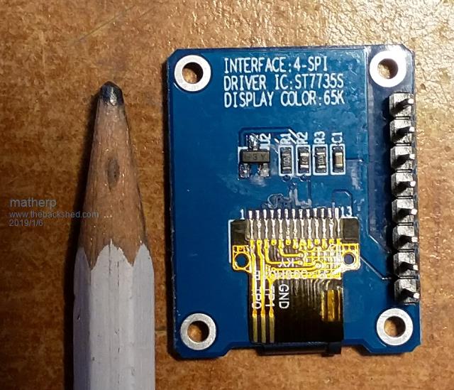

Just £2.81!
I've been looking for small low power displays for the Armmite L4 and came across this. Ideal for adding a "small" (pencil for scale) touch of colour rather than the SSD1306 etc.

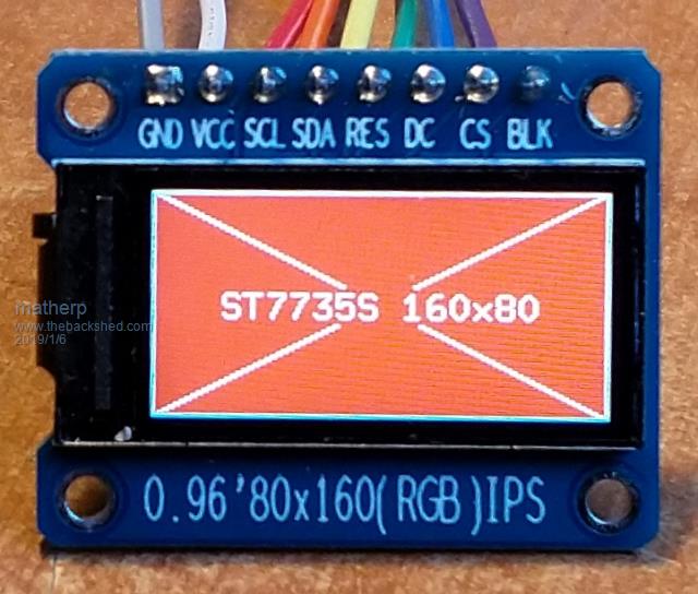

Loadable drivers for the MM2 and MM+ below. MM+ supports image load.
MM2
Sub mm.startup
Dim integer right=23, up=15, down=6 ' Left and push are reserved pins on Mircomite HAT stand for MM2
Dim integer key1=26,key2=24, key3=7
ST7735S 2,16,9, 1 'DCpin, RESETpin, CSpin, orientation (1-4)

  Quote  Any change you can post the C source for this one.
Sure, here is the complete MPLabX project
2019-01-06_182033_ST7735SLoadable.X.zip

  Quote  What is the BLK pin for? Backlight?
Yes
  Quote  Is the display's viewing angle any good?
Same as any other IPS display, very clear and bright
  Quote  If compared to OLED RGB, is this IPS TFT comparable?
No - it is 1/10th of the price

Just received my IPS display - all hooked up to a 28pinner with MMBASIC v5.05.01.
Using MM2 driver from Page 1 of this thread.
Am using the pins 2, 23, and 6 for the user defined pins (i.e. identical to the 2.8" ILI pins). Orientation 1.
It kind of works but I think there may be a RGB data 'INVERT' issue.
All other functions seem to work - i.e. TEXT, BOX, etc. Displays as expected APART from colours are incorrect.
On boot up, display is white (as opposed to black). CLS RGB(WHITE) will clear it (i.e. goes black).
CLS goes back to white.
CLS RGB(BLUE) goes to yellow
CLS RGB(YELLOW) goes to Blue
Hopefully enough there for you to see the 'pattern'
Note too that there is a white 'shimmering' edge to the screen (yes - I know I am sensitive to this )
Hope you can possibly see something wrong somewhere!
WW
Posts: 12084
Posted: 12:53pm 09 Jan 2019
Sounds like you have a different controller version - please provide a link to where you bought it.
In the mean time search for 24040021 and replace it with 24040020. There may be other changes but start with that.
Assuming that works: Type "box 0,0,mm.hres,mm.vres" in all 4 orientations and let me know the result. Also the me know if red and blue are swappedEdited by matherp 2019-01-10

  matherp said  In the mean time search for 24040021 and replace it with 24040020. There may be other changes but start with that.
One occurrence - and that has corrected all the colours (certainly for CLS RGB(....))
Still have a pixelated edge on Left and Top sides only (as before). Seems like a one pixel offset (in both down and right).
With the BOX 0,0,... command, I get the left and top edges of the box NEXT to the pixelated lines (i.e. down, and to the right). No Right or Bottom lines to the box (off-screen I assume due to offset issue?)
THANKS for helping - looks like a nice clear display (and very tiny!)
Will try the other orientations next; back soon with outcome . . . Edited by WhiteWizzard 2019-01-10
Posted: 01:25pm 09 Jan 2019
Upon Reset:
Orientation 2: (but with screen physically landscape; and pins along top edge): get pixelated line on left, and green(I think) line along bottom.
Orientation 3: Green line at bottom. No other lines
Orientation 4: Green dot in bottom right corner
and Back to Orientation 1: now there's no lines on left or top ??? BOX still shows top and left lines only
Will now go and do the BOX in each orientation . . .

THIS IS WITH ORIGINAL CODE. Your post came in during my tests!
Starting at Orientation 1: Blank on Reset. Left and Top Box lines only. Offset down and to the right
Orientation 2: Now only a white dot in lower left corner ? Box: Left and bottom lines only.
Orientation 3: white dot in each of bottom corners. Box: Bottom and Right lines only
Orientation 4: white dot in two right corners. Box: Right and Top lines only
NOTE: These tests were carried out with the code in Program Memory, and not the LIBRARY. Edited Orientation value, F1, Reset (Rst pin to GND), then observed, and did the BOX command.Edited by WhiteWizzard 2019-01-10
