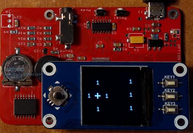

Search for Waveshare 1.3" LCD HAT. I bought it here.

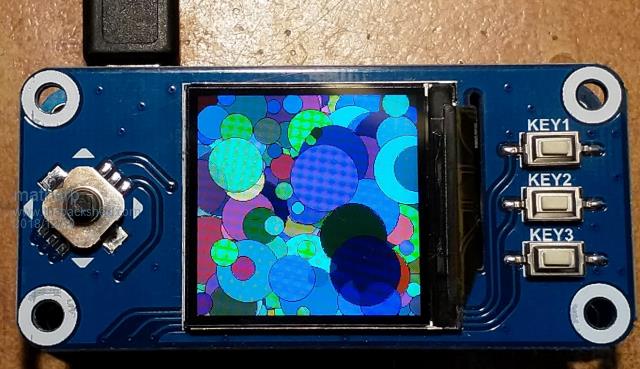

The display is 240x240 pixels and uses IPS technology to give a crystal clear image.
Loadable drivers below for the MM2 and MM+. The MM+ driver supports image load as well as the usual drawing commands. The pins in the example files support my HAT stand PCBs as pictured. Syntax is:
ST7789 DCpin, RESETpin, CSpin, orientation '(1=landscape, 2=portrait, 2=reverse landscape, 4=reverse portrait)
and of course the driver and MM.STARTUP should be stored in the library.
The pins on the pi header are 19=MOSI, 23=CLK, 22=DC, 13=RESET, 24=CS, 40=KEY1, 38=KEY2, 36=KEY3, 31=UP, 37=RIGHT, 29=LEFT, 35=DOWN, 33=PUSH. Corresponding MM pins on my HAT STAND PCBs are in the listings. I'll post an update for the Pi-cromite to support this display in a separate thread. In future, this display will also be supported on the MMX and Armmite L4.
MM2
Sub mm.startup
Dim integer right=23, up=15, down=6 ' Left and push are reserved pins on Mircomite HAT stand for MM2
Dim integer key1=26,key2=24, key3=7
ST7789 2,16,9, 1 ' landscape is natural orientation for display

Very interesting.
I note that this little module also has three tact buttons and what appears to be a SMD type of rotary encoder on the left. Or perhaps a four-way-with-OK button thing.
The listings for this module don't seem to state where these buttons and encoder are connected to. I expect they connect to the pins on the GPIO connector somewhere.
EDIT: I see that it is a 4-with-OK switch thing on the left, and your code gives us the numbers. I might have to get one of these to play with. $16 in NZ money - not bad considering you get the extra tact buttons.Edited by Grogster 2019-01-01
