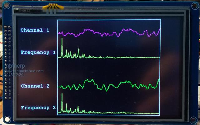

Please view the video
Cycle time is 180mSec and it is running a 1024 point FFT on each channel each cycle as well as playing a WAV file, running the ADC at 10KHz per channel and updating the display !!!!!
Only on the Armmite H7 of course.

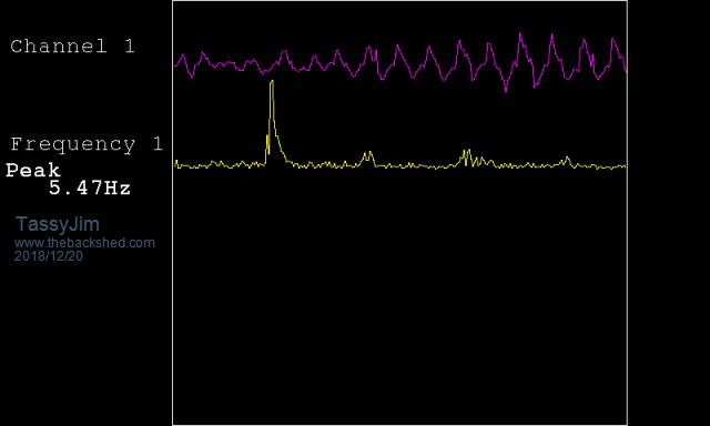

My first attempt with an MPU-6050 gyro measuring a tremor.
Most of the code is Peter's audio example with my bit filling the array with motion data from the gyro.
The readings were taken at 10mS intervals.
I saved the screen as an image after drawing it.
It takes a long time to transfer a 800x480 BMP with xmodem!
The measured 5.47 Hz is right in the expected range.

I'm delighted its working for you.
Attached updated version of my program that uses a drawing optimisation that I'd forgotten about - significantly improves cycle time. The change should be obvious.
