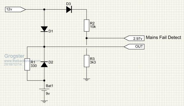

I do that all the time with my stuff that needs to remain working if there is a power cut. I do it the same way as lizby suggests in his post above - a diode gate.
I use rechargeable batteries, so that when powered, the battery is trickle-charged, but when the power fails, the battery can take over. All fully automatic.
I DON'T run a 5v battery though, I use a 9v rechargeable currently, and have LDO regulators in front of the MM a-la the MCP1703 series of regulators which only have a 200uA quiescent current.
EDIT: Just saw your mention of power failure detection. I have added that to the diagram above. This is how I do it. Just monitor the MM pin. When the pin is zero, the power has failed. When it is high, the main power is OK.
Please note that this trickle-charge method is NOT suitable for LiION batteries without additional battery protection etc, but for rough and ready NiCd or NiMH, it works beautifully. It is easy enough to also add DC power failure and battery monitoring via a couple more MM pins if required.Edited by Grogster 2018-12-15

Note that with the diodes, you don't need to do anything to switch to the new power supply, so unless you want to do something else when mains power drops out, you don't need to detect that it is gone.

What does D3 do for you in the circuit shown?
Posts: 10081
Posted: 02:46am 14 Dec 2018
In all honesty, it could probably be removed. My reason for including it, was that I did not want any parasitic power going down the line and into the output of the PSU when it was off if there was a mains fail. When I think about it some, the potential-divider would prevent anything serious happening there, so you could probably remove D3 entirely.

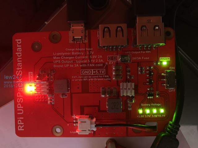

I've decided to get one of THESE
It will supply up to 2A and auto switches over on power loss

Posted: 01:18pm 20 Dec 2018
THIS
Works beautifully
It keeps the Pi running with no issues when I disconnect the mains power
