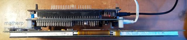

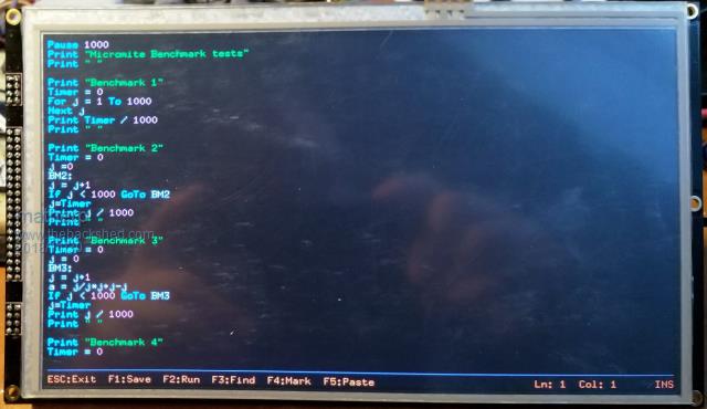

Just received my 9" ssd1963 display interfaced using Grogster's PCB
still got the screen protector on but WOW!!!
Option lcdpanel ssd1963_8_16,l
Edited by matherp 2018-12-01

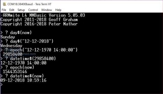

Posts: 12084
Posted: 11:16am 09 Dec 2018
Minor update that allows the EPOCH function to be used for dates before 2000 and changes the format of the day$ function as per the Pi-cromite and Armmite L4 to allow the date to be specified. EPOCH and DATETIME$ now work back to 1902 with epoch going negative before 1970.
