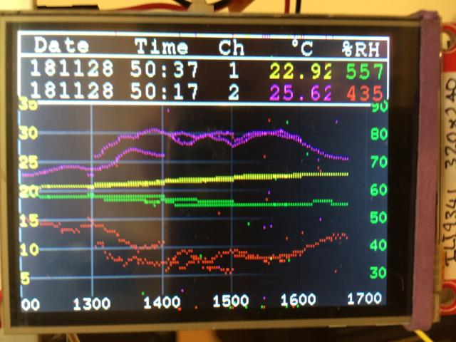

Gents I've got a problem that I can't figure out here. I'm plotting two Digoo 433 MHz Temp/%RH sensors on a 2.8" ILI9341 (320x240) using @TassieJim's receiving method and @disco4now's here decoding method. Their part is working fine but some of mine isn't - surprise, surprise! The timescale (x) plotting position (variable 'xposn') is the problem. It's supposed to plot pixels across the screen for a bit over five hours (320 screen lines/minute) then clear the screen, re-write the grids and start plotting again.
As you can see below, it doesn't. It starts fine for a couple of hours but then jumps back an hour, does another two hours and jumps back again etc. It does at least find the end of screen, re-draw the grids and start plotting again properly. I've included all the code below but as I see it, the problem can only be in the last half of the 'plotdata' subroutine or the middle third of the 'drawgrids' routine with the TIMER command at the end.
The firmware is MMBASIC v5.04.05 (haven't updated for a while). There's another issue with the 'boxed' coloured data results. They should always have 1 dec. place for temperature and just two characters for %RH as transmitted. I think the TEXT commands for these are right (again in the 'drawgrids' subroutine) and for most of the time they do display correctly - the overwritten area seen above is there when I check it in the morning after an all night run.
Any suggestions gratefully received.
Greg

Another thing I didn't mention. The Digoo sensors transmit a new result about every 50 seconds so there are typically a set of two plotted pixels for each channel (four colours) for each vertical screen line which represents one minute since the grid lines are 60 lines (mins) spaced.Edited by paceman 2018-11-29
