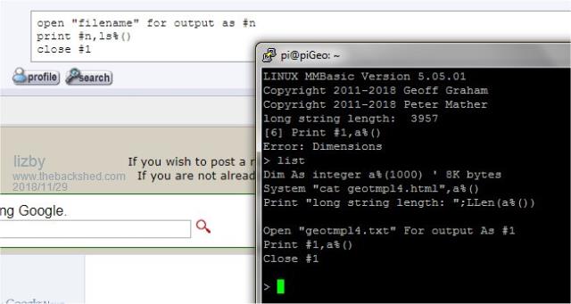

Posted: 07:02pm 28 Nov 2018
What am I doing wrong here?
This statement read a file of 3957 bytes into the long string.
system "cat geotmpl4.html",a%()
But then I couldn't print it. I've been able to process the long strings read in this way.
Edited by lizby 2018-11-30
Posts: 12085
Posted: 07:16pm 28 Nov 2018
  Quote  What am I doing wrong here?
longstring print #1,a%()
Posted: 09:47pm 28 Nov 2018
Bingo! Thanks.

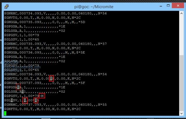

Posted: 04:09pm 29 Nov 2018
Hi
  matherp said   Please find attached version V5.05.01 of the Pi-cromite software. This brings the numbering back in line with the MM2/MM+
Have you install gps functions in futur, like in H7 ??Edited by goc30 2018-12-01
