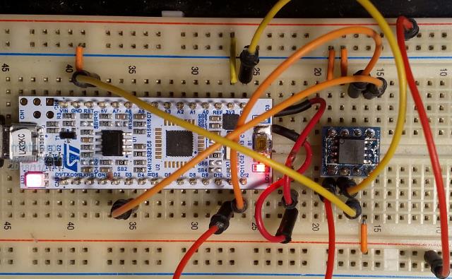

Wiring of the SPI flash is as follows:
Pin 1 : Chip select, connect to any free pin on the uP
Pin 2 : SPI data out, connect to SPI2-IN (D12) on the uP
Pin 3 : _Write enable, connect to GND
pin 4 : GND, connect to GND
pin 5 : SPI data in, connect to SPI2-OUT (D11) on the uP
pin 6 : SPI clock, connect to SPI2-CLK (D13) on the uP
pin 7 : RESET, connect to RST on the uP
pin 8 : VCC, connect to 3.3V

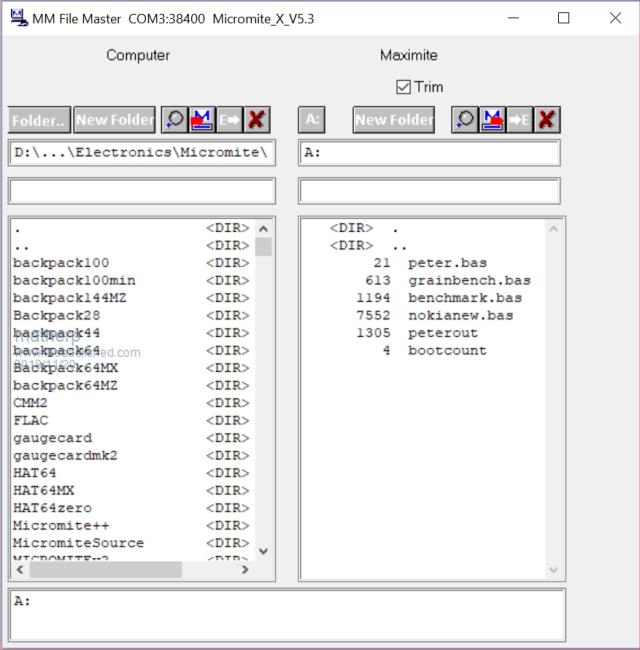

The MMEDIT filemanger is fully functional
The system will create and maintain a file "bootcount" on the flash memory. This keeps a count of the number of times the uP is restarted and can be interrogated with the function MM.BOOTCOUNT. The file can be deleted but will be re-created on next reboot.

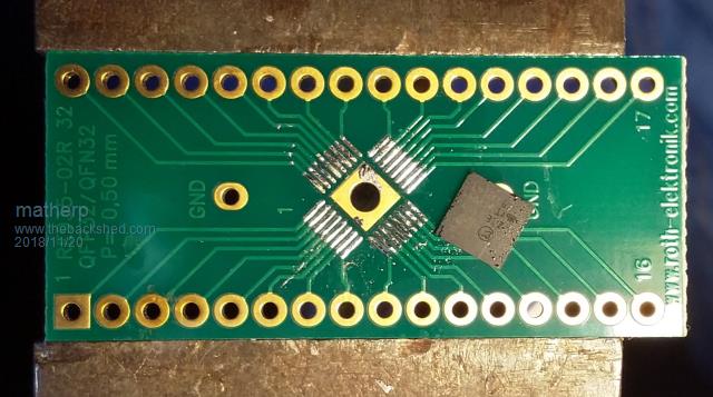

To solder it wasn't a problem, I tinned the connection on the breakout and applied lots of flux as in the first picture. Then I located the chip and applied the heatgun until the solder melted. The chip sat down nicely into the solder and all the pins checked out.

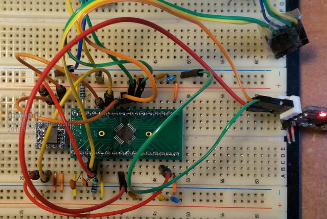

Required connections were:
Pin 1 - 3.3V
Pin 2 - 32KHz Xtal with 4.7pf cap to GND
Pin 3 - 32KHz Xtal with 4.7pf cap to GND
Pin 4 - 10K pullup to 3.3V
Pin 5 - 3.3V
Pin 8 - USB/UART RX
Pin 16 - GND
Pin 17 - 3.3V
Pin 25 - USB/UART TX
Pin 31 - 10K to GND
Pin 32 - GND
I used 0.01uF, 0.1uf, and 2.2uF decoupling on both rails

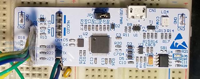

The taped together connection is for the ST-LINK programmer from a full-size Nucleo used to program the chip
Pins are:
ST-LINK Pin 1 - 3.3V
ST-LINK Pin 2 - uP Pin 23
ST-LINK Pin 3 - GND
ST-LINK Pin 4 - uP Pin 24
ST-LINK Pin 5 - uP Pin 4

Should be OK. I just use the top part of a Nucleo PCB which I broke off from one I killed. Also has the advantage it provides a USB/UART.
  Quote  Is the method of dragging and dropping the .bin file only supported with the extra parts on the development board that allow this method?
No, this is a function of the ST-LINK processor. The question mark over a clone is whether this is properly implemented and up-to-date. Certainly the one you linked doesn't support the USB/UART functionality
