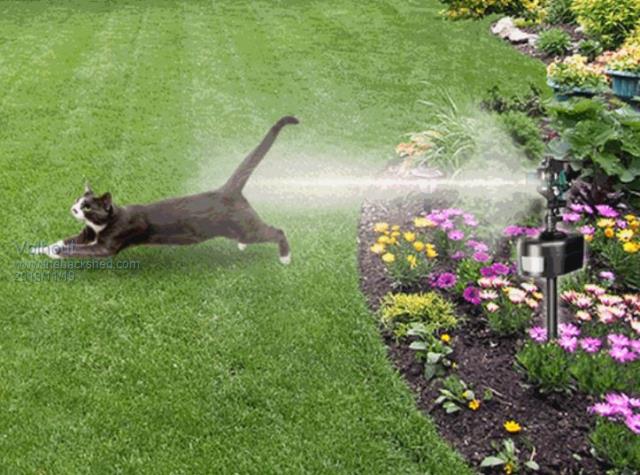

For about $100 there are bird/cat scarers that have a motion sensor which then squirts the little beast with water.
There must be a MM-based solution to detect movement and turn on a solenoid etc. to either squirt them or video them or?? (it would need to be humane and legal - no guns!).

Posted: 03:09am 18 Nov 2018
You have my sympathies.
Something like this might help. Cheap enough, self-contained, and says it will work on cats.
Or there is this crafty thing built by a fellow Aussie....
EDIT: ....and part 2Edited by Grogster 2018-11-19
