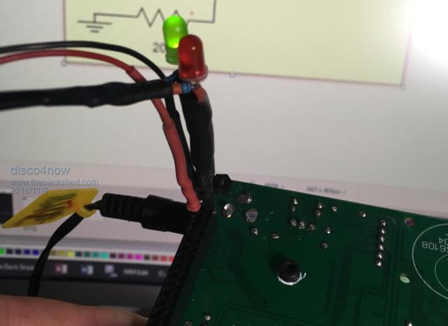

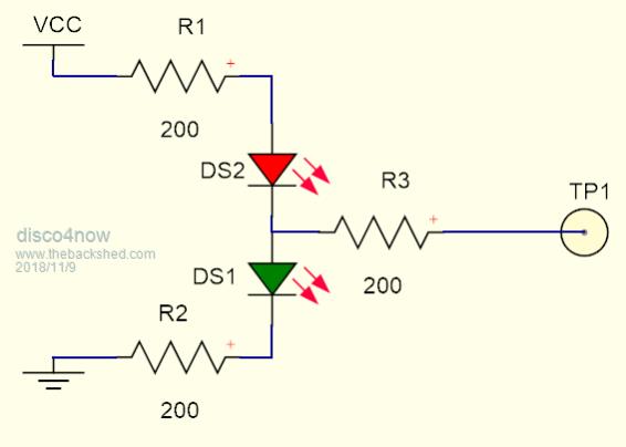

I built this LED version using a red and green LED and three 200ohm resistors.
You connect to 3.3v and Gnd and when the probe touches a high logic the green Led lights and when touches a low logic level the red lights, and neither lights for a high impedance. With the resistors touching 5v is OK as well.
Here it is probing the LCD connector on an E100

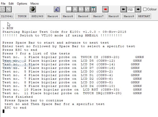

So if you have the console working you can load the program below and use it to set the pins of interest high and low and check them for continuity and shorts using the test lamp.
The program contains a list of the connections you are interested in testing and their corresponding MCU pins. The Space Bar steps through the defined tests and the console tells you which connection to probe.
A good test will be green Led 1 second,No Leds 1 second, Red Led 1 second, No leds 1 second during the four step test.
The Leds swapping from Green directly to Red with no off time indicates a short, you are on the wrong pin or there is an external pullup etc.
1. The pin is set high and all other pins set low. The pin being tested should show as high.
2. The pin is set OFF and all other pins remain low. The pin being tested is not high or low and both test LEDs are off. If either led lights there is possibly a short to another pin .
3. The pin is set low and all other pins set high. The pin being tested should show as low.
4. The pin is set OFF and all other pins remain high. The pin being tested is not high or low and both test LEDs are off. If either led lights there is possibly a short to another pin .
A pin with a pullup resistor will show high for steps 2 and 4
Initially set to test D0-D7 LCD-RST T-CS and T-IRQ on and E100 Board
The console as show during a full set of tests

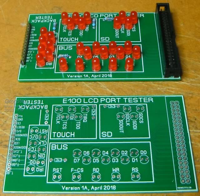

I also have a tester PCB available, for those who are curious if their port pins are working correctly. Third from the bottom of the page. Tests both the parallel and the SPI based MM boards.
MMBASIC code to use the tester is available from my downloads page.
PCB only. You need to supply the components.
