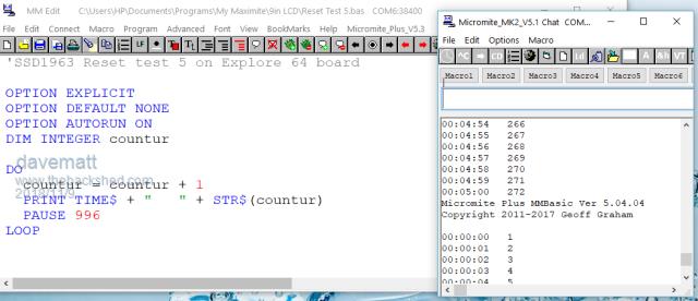

Hi all, I have 2 MM Plus mites running 5.04.09 running a counting program that reliably goes for 5 mins exactly and then restarts itself. Problem is, it's not supposed to! Can post the code, but truly, it's nothing but increment a counter and print.
Mites are freshly flashed, can see nothing to imply some sort of timeout. Can anyone help?

Hopefully this shows both code and result...
Thanks Jim and Grogster. Above is using 5.04.04. I cant find 5.04.08 in the archive, is it available somewhere else?
Will try the latest beta.
2 extra thoughts...
This test was on a brand new chip in an adapter socket, no change.
Can't see how this didn't emerge earlier, been playing with mm plus for years.
Only change my end has been a switch to Win 10. Oh hell...
