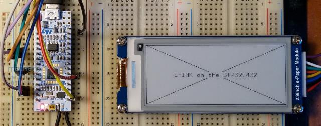

I've now included support for drawing functions and user mode display drivers
2018-11-09_022053_ArmmiteL4.zip
The example program uses the STM to switch power to the display so, as seen in the picture, the display is actually powered off - zero current usage - and the STM32 is sleeping @1.8uA. Based on using a normal 18650 LiFePo cell this should run like this for just over 100 years
2018-11-09_022827_epaper2.9.zip

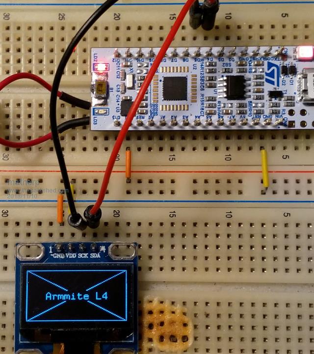

This version includes some new display drivers
2018-11-10_053808_ArmmiteL4.zip
Drivers supported are:
Nokia 5110 over SPI2
OPTION LCDPANEL N5110, orientation, DCpin, RSTpin, CEpin
and SSD1306 over I2C as in the picture
OPTION LCDPANEL SSD1306I2C, orientation [,Xoffset]
The optional parameter Xoffset is used to correct the display on 1.3" versions and should be set to 2 in this case.
You may also find that ILI9341, ST7735 and ILI9163 work as per the MM/MM+ over SPI2 but be warned these may be removed depending on space considerations as I implement more low power devices.
Edited by matherp 2018-11-11
