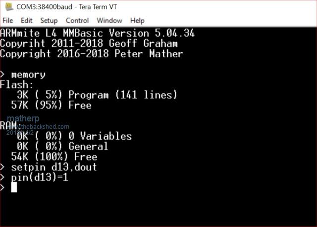

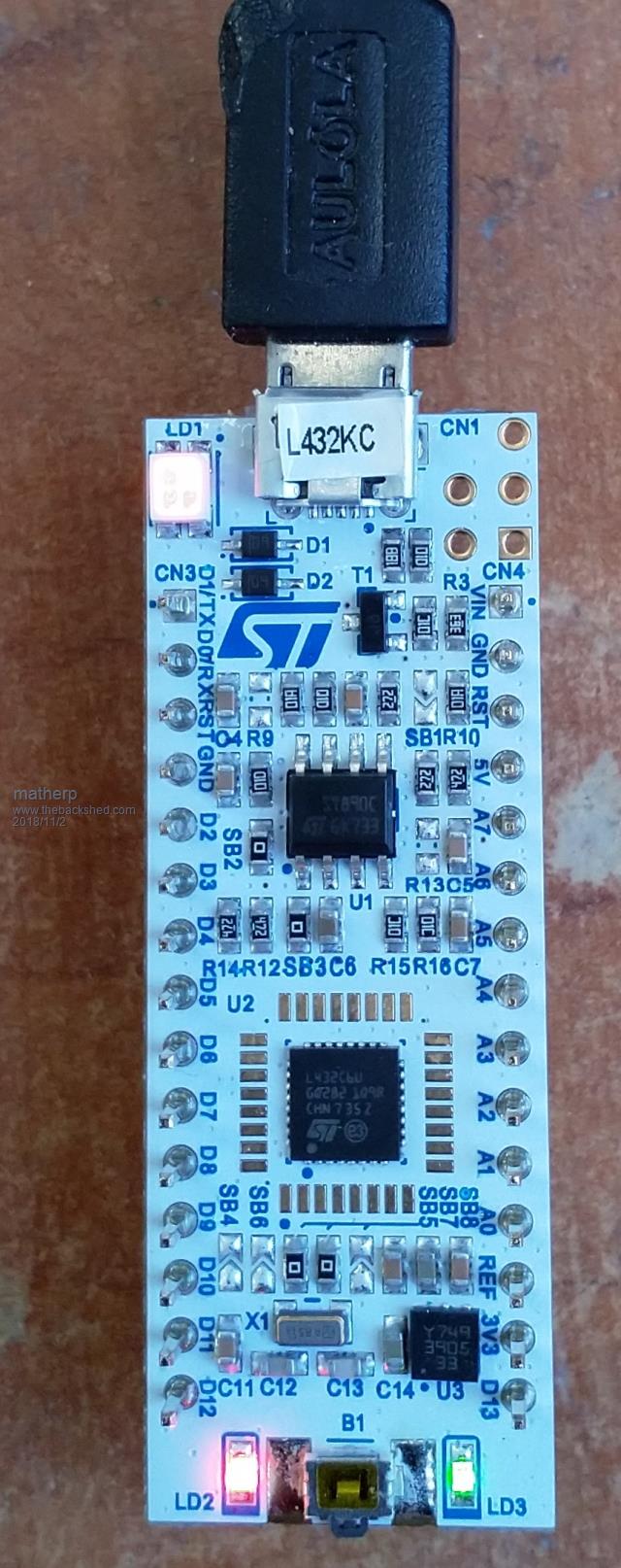

Posted: 08:18am 02 Nov 2018
MMBasic is up and running on the NUCLEO-L432KC - this thing is so cute - the same size as a 40-pin DIP and totally self-contained.
The code moved from the Armmite H7 pretty easily I2C, SPI, Digital-IO etc. all up and running. The big changes as always are in the memory model and the way flash memory is arranged.
I've got one issue with the console output occasionally dropping characters and haven't yet implemented any displays yet or played with the low power modes. The board labels the pins A0-A7 and D0-D13 so I have allowed this nomenclature as well as the normal pin number. Pin D13 is connected to LD3.
