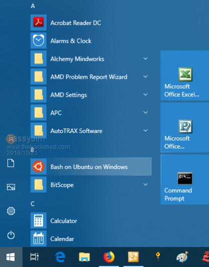

Posted: 06:39am 21 Oct 2018
Why stop at grep.
Bash:
You can get a lot more in Windows if you want a linux fix.
Compliments of Microsoft.
JimEdited by TassyJim 2018-10-22

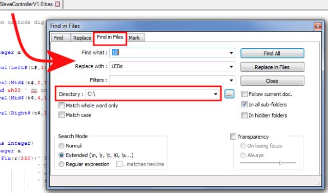

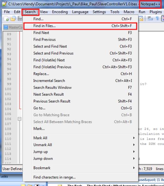

Posted: 07:22am 21 Oct 2018
  Quote  This little app is brilliant to have, as I can use it to search a whole folder full of log files for specific events, without having to open and search each and every one.
Notepad++ does this for you as well - very easy to use
Posted: 07:45am 21 Oct 2018
... what Peter said... and you don't have to step outside your editor.
Captain,
I also notice you are using some language formatting & folding in the images.
Have you worked on a custom one, or is that one of the built-ins?
Played with that a few years back, but had a few issues left unfinished.
Phil
Posted: 11:50pm 23 Oct 2018
I think I got it from here so it could well be yours. I refined it a bit, its still not perfect but I got it to a stage where it is usable and the bits that are broken don't bother me. here is the XML...
