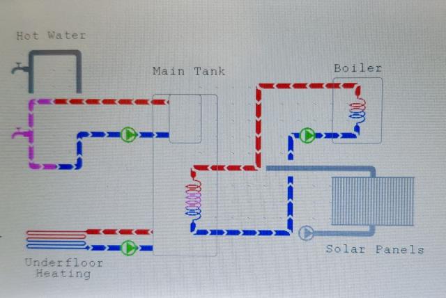

Following the help received previously, I have now achieved the desired result in my water circulation modelling!
I adapted Capt Boing's timer routines but used a different strategy from that shown in the example given by Gerry (above).
This shows a (rather poor) image from the panel:
or you can see the animation itself on this link: Animation
In an effort to reduce processor time and storage, I elected to create a new font, using FontTweak. Each symbol has up to three variants showing the chevrons in different positions. The program then 'prints' the characters to the screen every 200mS resulting in the display shown.
I haven't yet analysed the actual processor load, but my impression is that it is light. The font and the timer routines take up just 8% of the Library space which should leave me plenty for the remainder of the program!
