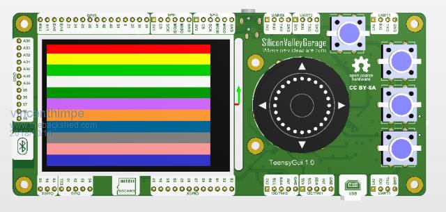

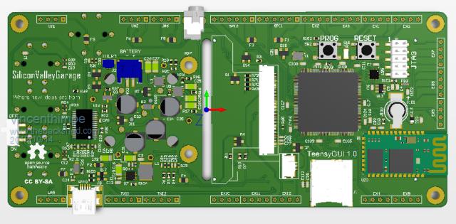

i am reworking an earlier design i did to port a Teensy (freescale) over to the STM32H7 chipset so i can run Armmite H7 and get rid of the whole arduino thing.
I use a SPI IlI9341 2.8 inch 320x240 but with a built-in capacitive touch controller on i2C.
The entire design is done in circuitmaker as a 4 layer board and open source.
- Bluetooth link
- sdcard
- usb console port (Silabs based)
- standby/power
- illuminated buttons
- navigator pad with rotary encoder
- 320x240 over SPI with capacitive touch

By the way you have a good looking H7 board there.

hmm... looks like the H7 support is not on par as the pic32 MZ support. Maybe i should do the MZ version of this board first. i got access to the source but i'm unfamiliar with the toolchain.
things i want to do :
- capacitive driver for the FT6206 controller
- enable all 5 i2c , all 6 SPI channels all 6 uarts including hardware handshakes.
- one SPI is hardwired to sdcard, one Uart is hardwaired to the BLe module , one i2c is used for system household ( battery gauge , navipad, buttons, led's ) the others are wired to board edge connectors.
