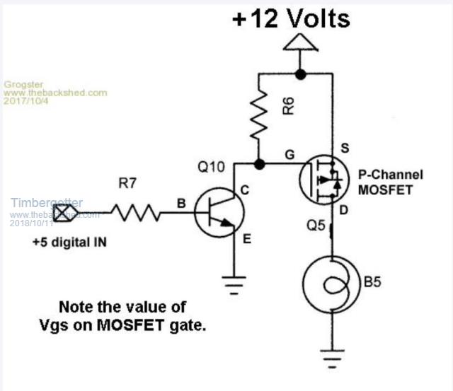

For sleeping the HC12, you can use your Arduino, and connect the HC12 SET line to a spare I/O on the Arduino, and use that to command the module to sleep and wake.
The other way is as CaptainBoing said - use a transistor switch. As the HC12 shares a common ground with the serial port and RF out, you need to use a high-side switch, or any other ground point will provide power to the HC12, and it could even operate on parasitic power via some resistors on the module to the 5v pin. Not enough to make the module actually work, but it could cause the module to misbehave(as it might have high-impedance power, but not enough current to actually do much, which can confuse the module).
I used a P-MOSFET and an NPN 'Helper' transistor as a high-side switch to control the 5v to the HC12. This has been documented elsewhere on the forums, but if you can't find it, I can re-upload the schematic or you can ask Mr. Google for an image of "P-channel high-side switch". To save four components(two transistors and two resistors), I just use the SET line on the HC12 now, and command it to sleep via code.

  CaptainBoing said  Which MOSFET did you end up using Grogs?
I used a DMP2305, which is SOT-23, and has an RDS of 90 milli-ohms at -2.5v
Vdss of -20v, Vgss of +/-8v, I=-4.2A. I helped that along with an FMMT493 NPN transistor in SOT-23.
When I did use this arrangement, I would switch the HC12 off and on when wanted. It worked fine, but using the SET line and commands in code saved me four parts. Technically in sleep, the HC12 still sucks about 22uA, but that is essentially nothing. The transistor method means the HC12 sucks no current at all when off, so if every single joule of battery energy is important, then the transistor method would still be a useful way to go.
Grogster, I found the above image on another thread and I guess it is the circuit you are referring to. You desribe it further in that thread with the following:
"This was what I have been using up until now, but it requires four extra SMD parts.
It is a high-side switch for just about anything with a common-ground.
I used 1k for R7, 100k as the R6, the NPN I used was an FMMT493 in SOT-23 flavour, and the MOSFET I used was a DMP2305 also in SOT-23. "
Many thanks for all your info.
