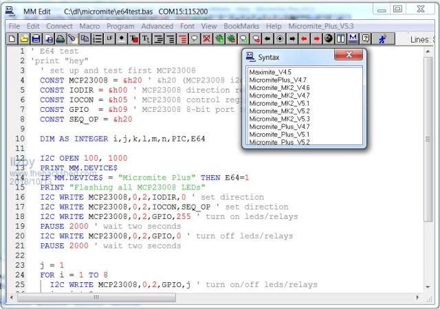

One snag along the way--when I click on the version-choosing item to the right of "Help", I can only see some of the options, and see no way to scroll. I clicked the bottom option, clicked the chosen item again, hit the down arrow, which chose the next, invisible option, and then repeated that until I got to Micromite_Plus_V5.3.

The list should have a scroll bar.
If your mouse has a scroll wheel, it should scroll the list for you.
What version of Windows are you running and do you have any scale set other than 100%?
Posted: 12:13pm 12 Oct 2018
Windows 7 on a laptop--no scroll wheel. I'm not sure what scale you would mean--other than for certain browser windows, I don't know that I have any scales set.

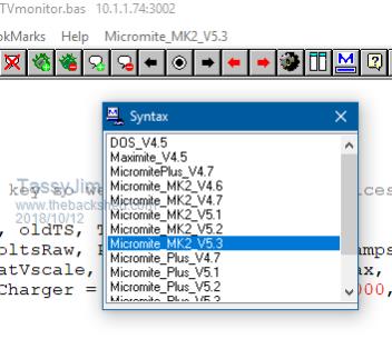

Try this TKN file. Replace the one in the program folder. It will make the pop-up a bit wider and will hopefully show the scrollbar.
The problem is caused by the different sizes of the borders around the windows.
2018-10-13_071113_MMedit.zip
Post a screenshot of the pop-up please.
If your display is high resolution you might have it set to display text at 125% or 150%. That can cause issues but I don't think that is the problem here.

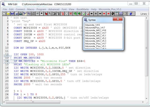

Posted: 11:51pm 12 Oct 2018
With new TKN file, the pop-up appears slightly wider than before, but no scroll bar.
Screen resolution is maximum available on my laptop, 1600x900.

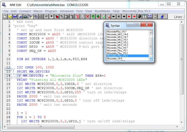

This TKN has sizing controls on the pop-up so you should be able to size it to fit the full control, complete with scrollbar.
2018-10-13_122138_MMedit.zip
A screenshot with the pop-up sized will help me set it for you.
I can't leave the sizing controls on it unfortunately.
Posted: 02:44pm 13 Oct 2018
That did it. Scroll bar appeared without my doing anything. Thanks.
