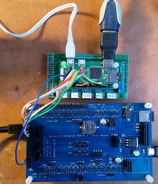

This version includes support for an HDMI monitor using a Raspberry-Pi Zero as the HDMI interface
2018-10-09_023933_Armmite1.3.zip
Pin connections between the two are 1:1 as per the 8-bit SSD1963 pinout in both cases with the exception of the RD pin so there are 8 data pins and 3 control lines (+ a ground connection).

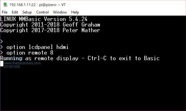

To put the Pi into the HDMI I/F mode do as follows:
rm .options
run the Pi-cromite software as normal (sudo ./mmbasic)
OPTION LCDPANEL HDMI
OPTION REMOTE 8
You should see the following screen:
You can return to the Pi-cromite Basic prompt by typing Ctrl-C
and cancel the remote functionality with
OPTION REMOTE 0

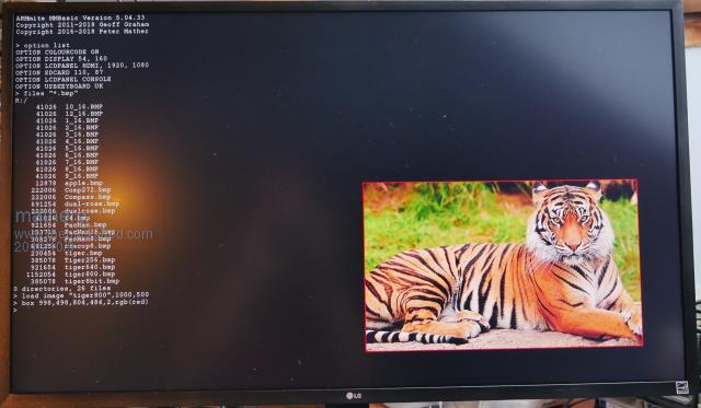

for a 1920x1080 display as in the picture I've used
sdtv_mode=2
sdtv_aspect=3
hdmi_group=1
hdmi_mode=16
disable_overscan=1
